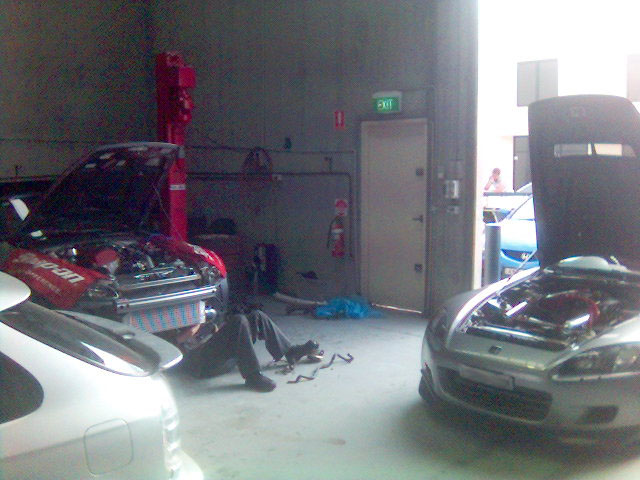

How often do you see two turbo S2000s in the same room?
http://s2000.byteserve.com.au/today/Picture(20).jpg
Close up of Steve's beast:
http://s2000.byteserve.com.au/today/Picture(21).jpg

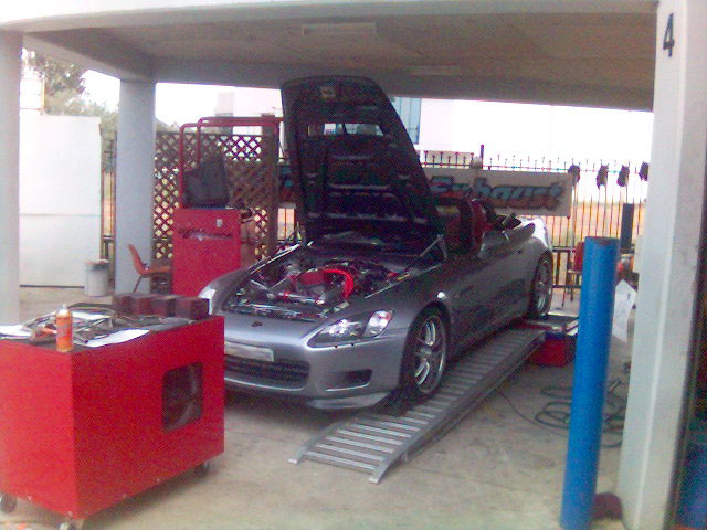

Mine on the dyno:
http://s2000.byteserve.com.au/today/Picture(22).jpg
dam looking goooooooooood
Any power figures?
We're still at around 213Kw. We were tuning for midrange today.
Once we get the boost control sorted we will experiment with more power, but they may wait until I install the new block.
That's the first time I've seen my car for five weeks! But it put a big smile on my face :)

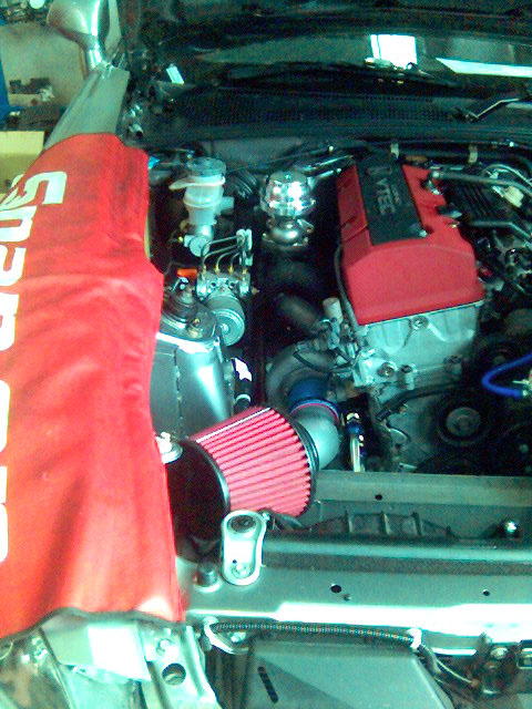

After six weeks anticipation, I finally got to drive a turbocharged S2000.. My turbocharged S2000!! And it is awesome. Adrian had some issues tuning it, most of which went about 10 metres above my head. But the final consistant power @rw was 184 kw (it was 134 in stock form). So a 50kw gain with the stock exhaust system.Quote:
Originally Posted by AusS2000
The best part is that it is really quiet and the only sign that it is not stock is pssst from under the bonnet when I floor it.
If anyone was on the M5 around 18:30 and saw a silverstone blurr- that was me :)
3" zorst time....oh and who predicted the power output? lol
congrats man.....vtec turbo is awesome
Yes I did think of you when Adrian said 184kw. Strange thing is that I don't notice the VTEC anymore, the torque is pretty constant right up to redline from around 3000 rpm. I think Adrian said that VTEC is coming in at 7000rpm now, but I can't tell because once it gets to 7000 it zips to redline in a fraction of a second.Quote:
Originally Posted by superR
It gets really really hot in the footwell i notice, you could have had a BBQ on the turbo after 90 minutes of driving. I've also lost the stock oil cooller/heater
because that's what the Revhard kit required (the oil filter has been repositioned). So the next job is to get that and the temperature guage sorted (AEM EMS can't drive the temperature guage for some reason). I've got the driver for the temp guage from the US, and Adrian will sort the Oil cooling issue for me in a few weeks.
The main reason you 'feel' VTEC is that the power is dropping off before it. Witht he turbo you have good usuable power throughout the range so there is no real noticable changeover.
dude that oil relocation kit you got allows for an oil cooler to be put on......its hell easy man ..... just ge adrian to hook you up with all the gear dude.
oh and ps , looksa awesome where they put the oil filter now doesnt it. lol
