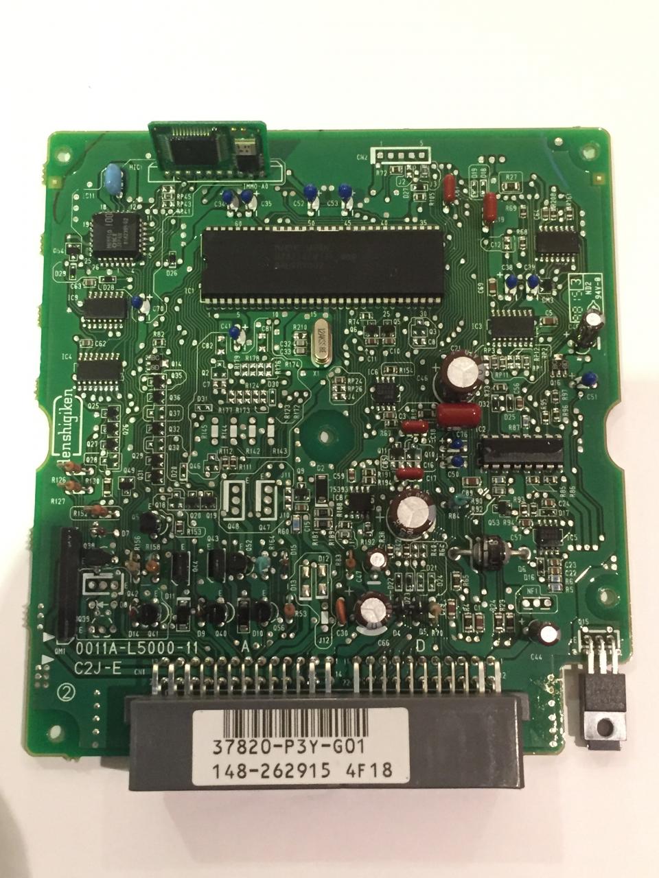

I have 3 EJ9 Civics and I think all of them have the same P3Y ECU.
My son somehow peeled away the black part exposing the chips on the keys on one of the cars .. (he lost one chip and the other one is being held in place with electrical tape..)
I want to remove or disable the immobilizer altogether.
Do I need to find some chip sensor box under the dash as well?
Attachment 29096
Your P3Y ECU is much like our P2K ECU for the D16Y4, so yes you will need a bypass module for those ECU's.
