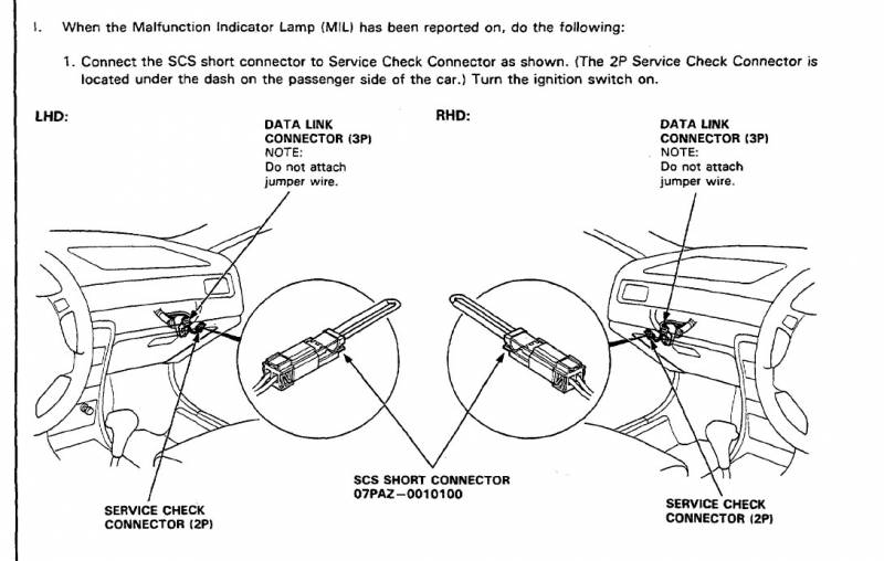

hey guyz, was tryng to do the ecu test yesterday but had no luck in finding the green holder with 2 blue plugs, all i found was 2 blue plugs hanging loose but didnt have the brown and green wire, but instead one plug has 2 wires black and brown and the other had 3wires light blue, brown and pink. would the blue plug with black and brown be the one im looking for? if it is..
just wondering why would it be hangin loose and could i still use it to perform the ecu test, or are my plugs just located in a completely different location,
thanx
its the plug with 2 wires on it. Use this guide the same way....Quote:
Originally Posted by khOa`
so use that plug for the test?? kool thanx

ive got a honda EK and this is no where to be seen?
i cant find the ecu testing thing on my EK either anyone?
i cant find it too
can any1 confirm that the ek 1 is there?
see that strange i can see the three wire connector but no 2 wire connector around it at all....?
im just looking without removing anything (carpet, lids etc)
try and look around the same area - should be there somewhere.
Here is the location according to the official HONDA EK guide -
http://www.ozhonda.com/gallery/data/500/ECUTEST.jpg
think itll make it easier if i remove glove box?
i wonder how hard they are to remove
i removed glove box and only 2 wires i could see is two grey wires which on their other end is a 3 wire connection (2 --> 3 wires)
the connector you are after is a 2 WIRE connector.
Keep looking its there.
trust me ive looked everywhere possible, the only two wires i see running together are ones connected to the three wire connecter, can anyone who has done it on a 96 ek advise please

Any 1 know where can i locate it in a 88 ef7 crx ?
*correct me if wrong*
the ECU is in the same place ( passenger kick panel) or under the passenger seat. The ECU light is located on the ECU , in the centre and will flash a code if needed.
ya wrong benny boy,how dare u not have intricate knowledge of crx's!
ecu for crx gen 2 is in the passenger footwell against the firewall,just pull back the carpet & u'll see it under a gold plate with a little hole in the middle for the ecu light.
Thanks man!! will give it a check... n let u know... hehehehe... :P
Cheers
found the connector..which has 2 wires lying beside the ecu... not plugging to anything... which is use to plug the paper clip to test for any error.. b4 i start the test..i dun seem to see any lights on my ecu..as the middle of my ecu is a screw.... currently running a PR3 spoon ecu on my ef7 crx... will tat means the light will be shown on the dash if i start the test ?
