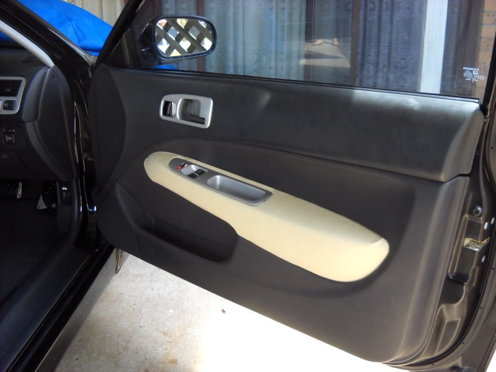

hey mate great diy, i have started it an im up to step 7, im using epoxy bond but it aint the paste.
im havin trouble putting the arm restback onto the door panel
could someone please help me:D
i can get it on there but i cant get the epoxy bond 2 stick
screws + washers are your friend
ok ill give that ago then ill post up some pics once i get it back on.
cheers:D
any luck?
yeah theres a couple ways with putting it back u can do the epoxy way, or screws and also can use cable ties, i will upload some pics tomoz:D
Im sure you can find megapoxy or similar at bunnings etc. Normally the thick 2 part adhesives are the strongest. on mine even when the adhesive eventually detached from the armrest it acted as a stopper and didnt budge at all. Washers and screws are a good but if someone is really rough with the arm rest theres a chance of it coming out or broken off.
If i was to do it again i would use screws+washer and some strong adhesive like liquid nails etc, in the end if u do want to take it off, unscrewing it would break it off from the adhesive anyway. (thats provided u didnt go crazy and apply glue all over the place lol)
