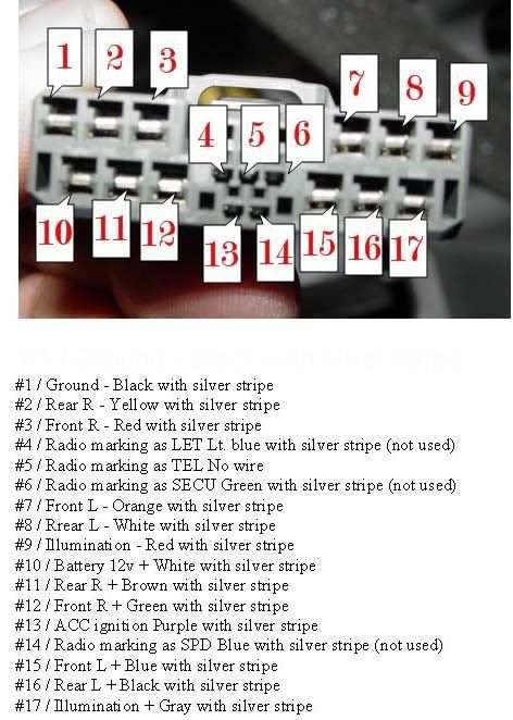

i'm upgrading the audio on my new fd and was just wondering if anyone had the wiring diagram for the wires that come out of the stock head unit and what they do?
i'm connecting a rockford fosgate 3sixty.1 and need to know which wires are for the speakers?

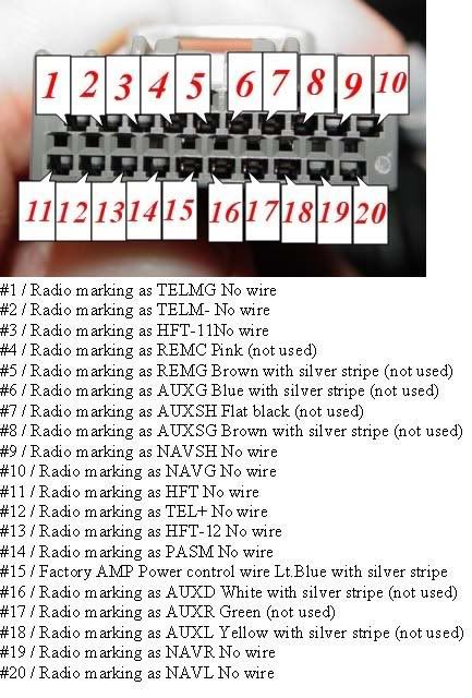

sorry for late reply, my HDD folders are mess up :thumbdwn:
HARNESS 1 - mainly for audio system (you might need this much)
http://i171.photobucket.com/albums/u...a/harness1.jpg
HARNESS 2 (VTI-L and sport only) -mainly for steering control audio button & AUX
http://i171.photobucket.com/albums/u...a/harness2.jpg
please see how the harness facing and point the number carefully
Wire's color may vary.

awesome! cheers mate!
that must be the most complicated thing ive ever seen in my life

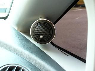

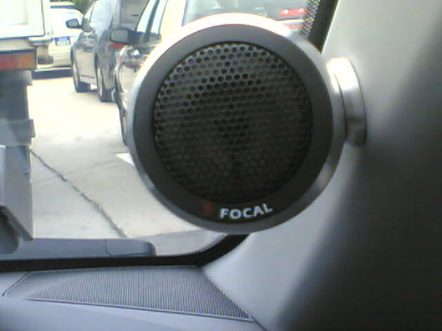

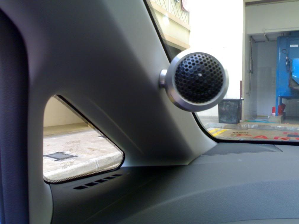

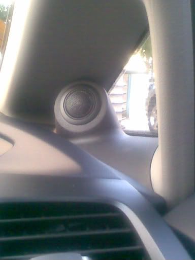

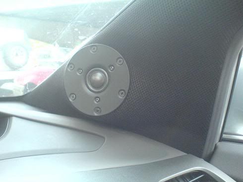

for everyone with splits, where did you mount the tweeters?
i'm trying to figure out where i want to mount them... the spot near the windscreen where the oem ones would go if i had them doesnt look like the best place to put it so i'm wondering what everyone else did...
hahaha true2... ^_^ I believe in other country the civic sports comes with OEM tweeters... or maybe not :p
yeah...we've been thru this...they're playn with us...it looks like ther are tweeters in there but there actually isnt...just an optical illusion

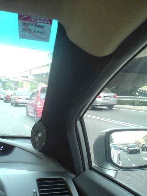

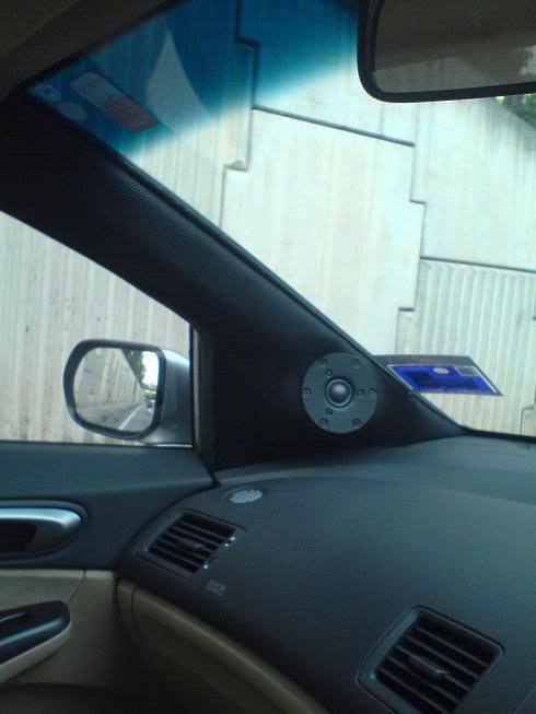

few options :
1. A pillar
http://i227.photobucket.com/albums/d...2007002rx4.jpg
http://i227.photobucket.com/albums/d...0062007277.jpg
2. mirror triangle (scarifice)
http://i25.photobucket.com/albums/c9.../DSC00150a.jpg
http://i25.photobucket.com/albums/c9.../DSC00151a.jpg
http://i25.photobucket.com/albums/c9.../DSC00152a.jpg
3. Mirror triangle - non scarifice but messy
http://i227.photobucket.com/albums/d...EETERCOVER.jpg

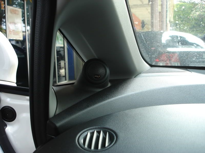

4. The best :thumbsup: Mirror triangle -custom pod
http://i32.photobucket.com/albums/d3...8/DSC09337.jpg
http://i305.photobucket.com/albums/n...0/Image036.jpg
how bout the oem spot??i rekon that wuld look nice and wont attract B*****Ds like thieves
1. oem spot too far, the sound won't be max
2. the tweeter would be facing upward, and the sound would reflex to windscreen and bounce back.
3. oem spot sometimes too small to fit good tweeter (read : big size)
4. we need the tweeter to face to us to get best sound.

That's all true- sound stage isn't the best (so that means points 1,2 and 4 are identical!)... but as you mentioned as well, it's neat and tidy- and people outside who look in, won't know you've modified your sound system and it's less likely to attract attention from bystanders. That's the biggest reason why I did it that way too.
