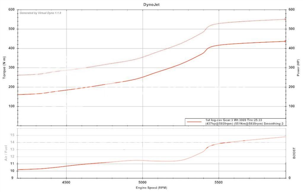

finished the road tune today and so streetable now with plenty at WOT . ignition needs sorting as it breaks down around 6000rpm , which i will sort this week . here is a log through VD on believe it E10/91ron @ 20psi .
http://i431.photobucket.com/albums/q...matt7-9-12.jpg
