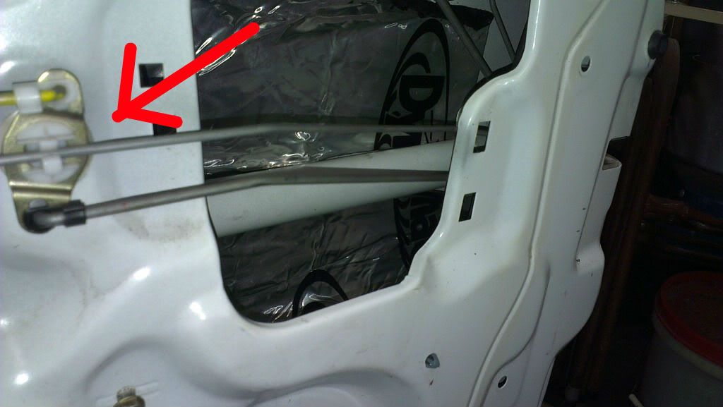

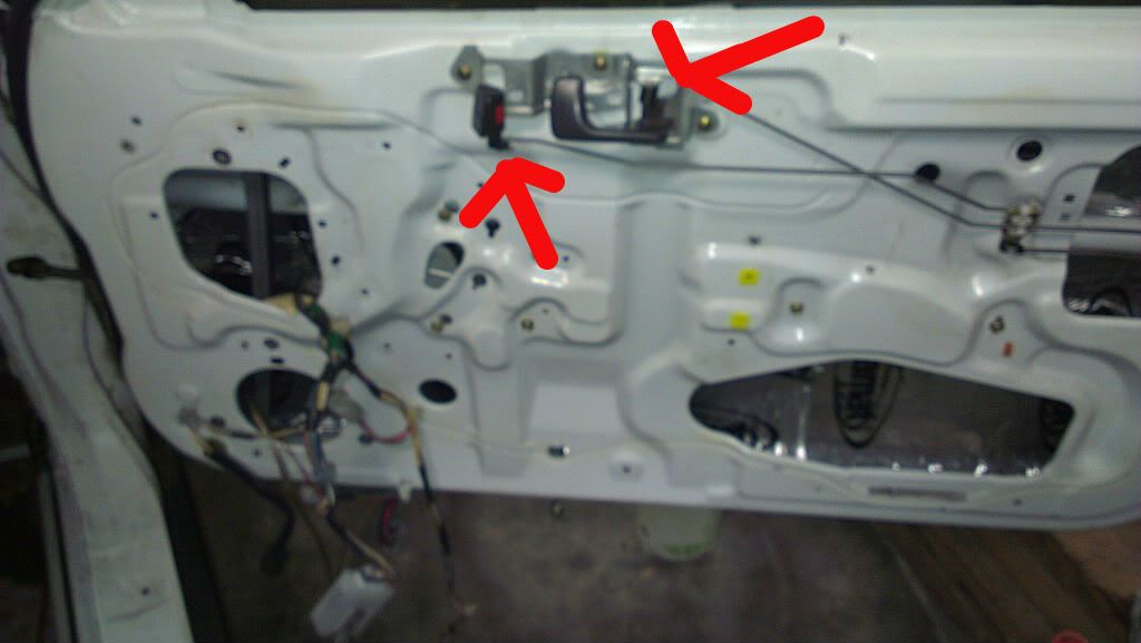

i used htb grease cause i had a tub sittin round from doing mates wheel bearings, you just dip your finger in and put a big glob of grease at the point the lock rod connects, becausae its so thick it will make it hard for the rods to vibrate where they connect which is where the problems coming from.
You put a bit here

and pack heaps around this bit

Ah I see now! So, you reckon, remove the foam & pack grease on those points? Will definitely give it a shot on the weekend. :)
hard to say without seeing what you have done but if you have used foam to stop them vibrating then there is a good chance you have created extra resistance for the lock to open and close which would explain your problem, using grease on the point adds very very minimal resistance to the open and closeing but restricts the connections ability to vibrate.
Ive got solid polyurthane hasport mounts on my car and just using grease stopped mine rattleing.
those points can get worn over time as well.
nothing can help this.
Yeah, I would definitely say that the foam has created resistance, but that was part of the idea and it seems to have created a bit too much resistance now. The biggest problem with my lock is not really the vibrating, but the fact that the rod connected to the 'switch' (the thing you press down/flip out to lock/unlock the door) doesn't hold the switch too well, the switch is given too much leverage to move on it's own around the rod. I think that's where I'll have to pack the most grease, try and get plenty in between the 'loop' of the switch and the rod that holds it.

if its really worn you could wrap the end of the lock rod in a small ammount of electrical tape to reduce the gap, then pack grease around it, i probably wouldnt use blutac as thats quite hard and sticky so might just run into the same problem again, also if the switch moves around easily you can put grease behind it on the point it mounts to make it not wobble around so easily, i did this on my passenger door as the switch would vibrate at certain rpm or bass hits and it has stopped it.
