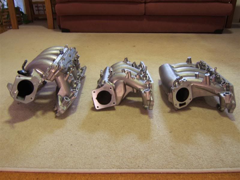

Let the testing begin...
LEFT= RBB --------- CENTRE= 1/2 RSP --------- RIGHT= RBC
http://i239.photobucket.com/albums/f...2574Medium.jpg
http://i239.photobucket.com/albums/f...2569Medium.jpg
http://i239.photobucket.com/albums/f...2572Medium.jpg
Sorry i dont have the whole RSP yet, awaiting the bottom plenum...
awesome! the RSP definitely looks the best of the bunch. Looking forward to the results
we'll soon find out...

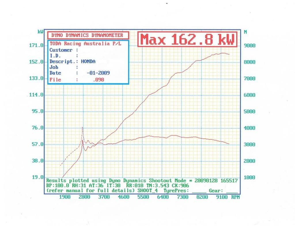

Customer Car
Engine - Sleeved B18C + Ported P72 head
Displacement - 1933cc
Bore -84.00mm
Stroke - 87.20mm
CR - >12.8:1
Camshafts - TODA Racing
Camgear Settings - 105deg LCA (intake & exhaust)
Gearbox - DC2R + TODA 1st & 2nd + ATS final drive & Quaif LSD
I/H/E - Custom intake / Air pipe / BTCC carbon surge tank / Jenvey quad throttles,
TODA (designed) Australian made 4~2~1 Race header + custom cat back
ECU - HONDATA S300
http://i235.photobucket.com/albums/e...edat1628kw.jpg
The current state of tune has only been roughed out.
A few changes are to be made in key areas of system before final tune.
More torque & a little more power is expected on completion.
Fuel type used is 98 RON pump gas from BP.
Switch to E85 fuel is also likley in the future. ;)
wow impressive!
