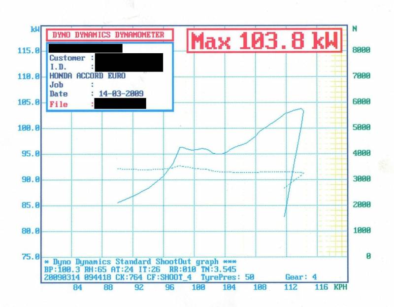

still... can you post the dyno result? want to know what the power figure ATW for the CU2
Yep, keen to know the dyno results as well.

Dyno result for CU2 Auto running on Vortex98 and it was done today not 14/03.
http://www.ozhonda.com/gallery/data/512/CU2Dyno.jpg
the 145kw is quoted from the engine.
A dyno measures the output from the wheels, so whenever a manufacture quotes a power from the engine, so its 100kw atw ( i think) something like that
the CL9 is around that with around 35kw loss through the transmission...
so not surprised that the cu2 would be round the same too.
How much of difference does an auto trans make to power ATW? Would expect more loss versus a manual.
