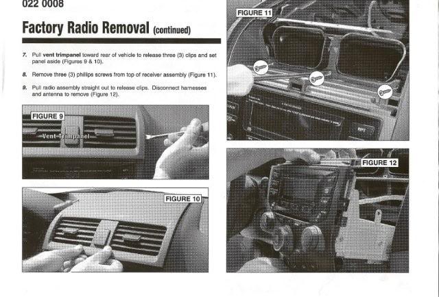

Anyone know where i can find a tutorial or guide on how to install the xcarlink on 06 sat nav auto euro, i can only find a youtube video on a manual euro without sat nav!
Its really easy, all you need to remove is the top vents (slide forward and up) and then remove three screws and pop out the sat nav unit, plug in the xcarlink and put everything back
OH shit ive been working from the gearbox upwards and im having trouble removing a screw, so instead of working from the bottom gearbox to ashtray (i even removed the DVD drive bay) i should js remove the top air vents? OMG FKFKFK ><"
This might help...
Attachment 16413
