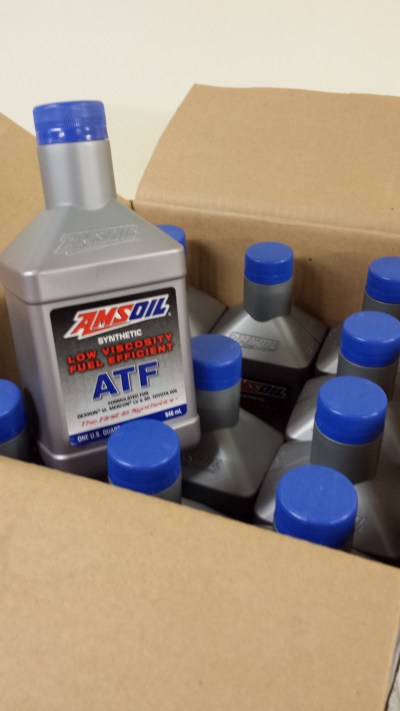

My Amsoil guy just dropped a box of 12 quarts of Amsoil ATF ATL - Low Viscosity ATF. Was disappointed how the Honda DW1 goes off so quickly.

Attachment 28378
nice, how much did it cost you?

Its cost $200.00 including delivery, so a little bit more than the Honda DW1.
Let us know how it goes. I been thinking going amsoil:)
