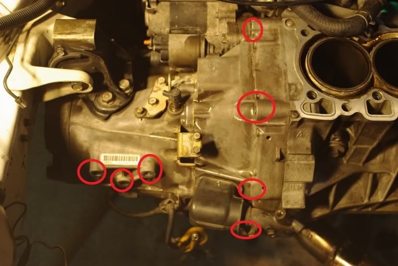

http://i101.photobucket.com/albums/m...IMGP3348-1.jpg
Ok so im at this point and ive removal all the bolts in red circles plus a few undernieth and ive just left the bolts on the main engine mount and one on the rear mount. Im unsure if i just unbolt it all and slide it out will the inner cv joints come out? or do i have to remove the inner cv joint boots etc?
I've done this once before but ive completely forgotten.
Wat are you doing to ur motor dude??? when i removed my gearbox i firstly removed the drivers side shaft completely but left the passanger one in, just popping it out of the gearbox plus im pretty sure ur gonna need to unbolt the halfshaft or its not gonna tilt to let u remove the box.
Goodluck
starter motor has 2 bolts from memory, you;ll need to support the engine with jack and wood so it will not damage the sump, drain the box, remove cv, and it'll take some force to remove it, you'll most likely need a pry bar or some form of wedging point and a breaker bar.
also the top mount connecting to the g/box needs to be undone as well
wasn't there a diy thread on this ? might wanna look into those shift linkages as well in case you haven't done anything with them
