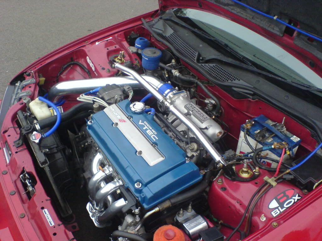

Well thanks for all the advice guys but i still went ahead with the upgrade, it went 68mm s2 TB and s2 IM ported to a 68MM, the car has gain alot of torque and power throughout the rev range, if anybody is looking into this upgrade it will be worth it and will not regret a thing, not the engine bay looks great and the drive is awsome! :D :D :D
http://i954.photobucket.com/albums/a...8/DSC00918.jpg
Looks f'ing mint in that bay of your's mate. Good for you :)
keyboard warriors FTW lmao.
looks nice, im liking da blue rocker cover. wat other mods u planning to do??
What bolt-ons are you currently running? IE what brands? Headers look nice :)
intake and exhaust are both unbranded, liverpool exhaust did my full exhaust system, 4-2-1 headers ceramic coated, high flow cat, and a basic looking cannon, intake is a injen replica, also made at liverpool exhaust and ceramic coated aswell running a blox velocity stacker pod filter, i got spoon leads, 550hp fuel pump walhbro, using castrol edge sport 10w-60w, platinum plugs...the intake manifold and TB also done as stated above and seen :cool:
in the near future id like to get a lightened flywheel and 6 puck clutch, running a exedy heavy duty clutch at the moment.
further down the track going to be doing full head work.....hope all goes well!
how much did the ceramic coating cost from livo exhausts?
Good to hear the result of the upgrade from the OP himself... good to know the outcome is positive.
