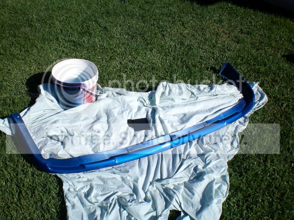

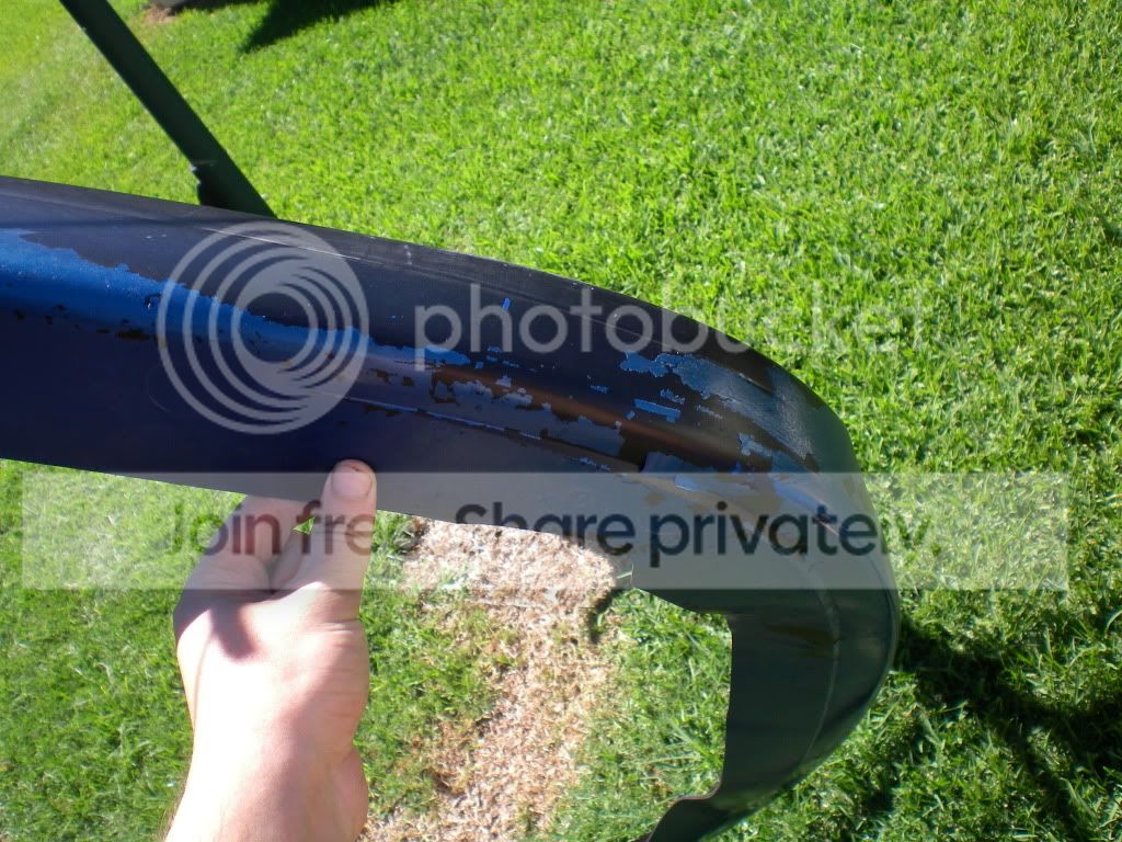

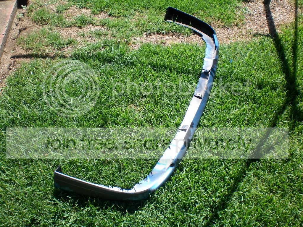

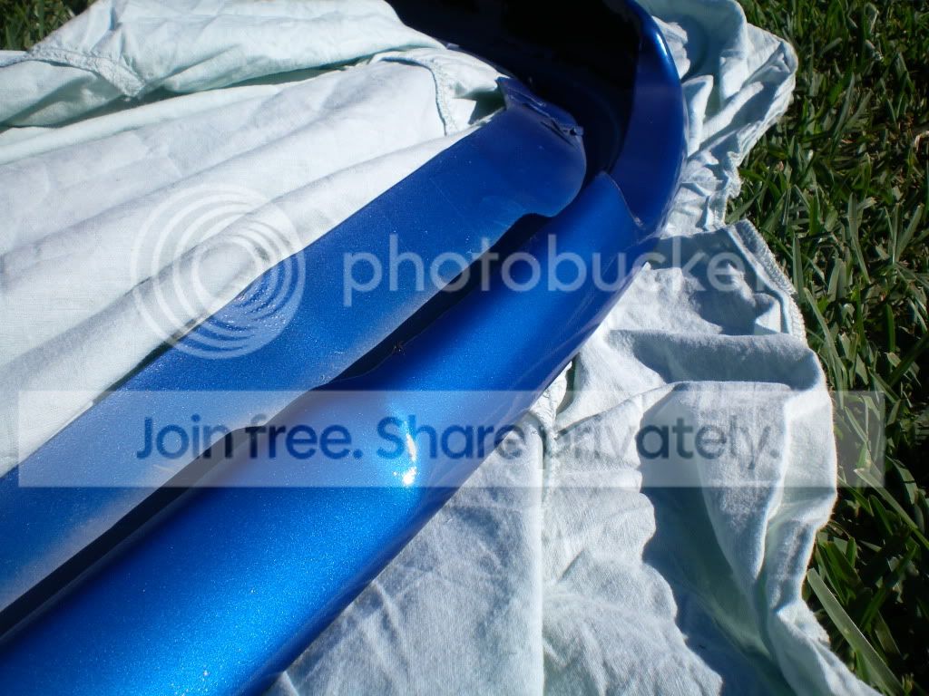

Here is a front lip I did with a spray can:
From this:
http://i408.photobucket.com/albums/p...e/UNI_1552.jpg
http://i408.photobucket.com/albums/p...e/UNI_1554.jpg
To this:
http://i408.photobucket.com/albums/p...e/UNI_1567.jpg
http://i408.photobucket.com/albums/p...e/UNI_1571.jpg
Note: inside of the lip wasn't sprayed on purpose as it's not seen once fitted onto the car.
