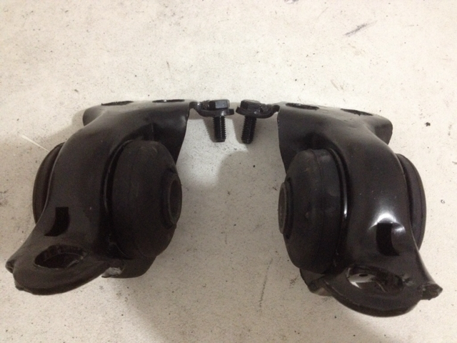

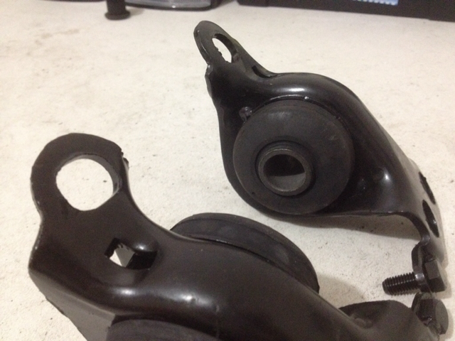

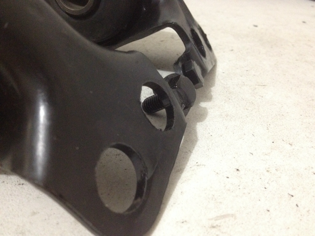

Followed this to do the RTA bushes today. Probably should add if you are going to take the arms out as detailed here, you need to disconnect the hand brake cable and also the abs sensors (if equipped). Both easy jobs.
I also found it easier to just take the brake calipers off rather than play around with disconnecting hoses and getting fluid everywhere.
