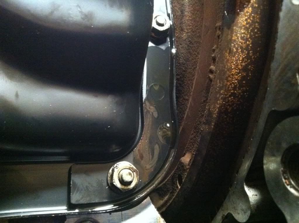

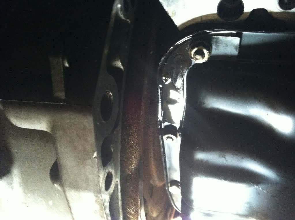

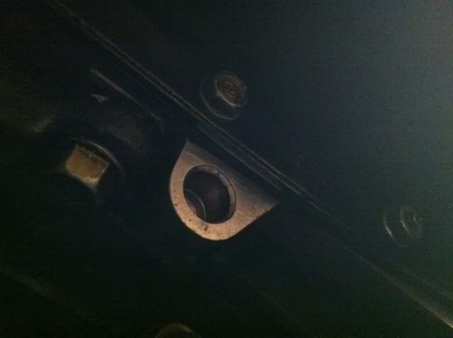

filled the car up with oil, came back an hour later and checked it, perfect. started it for a bit, came back another hour later to find a nice fkn fat leak on ONE corner where the block meets the clutch housing.
http://i582.photobucket.com/albums/s...er/photo-5.jpg
http://i582.photobucket.com/albums/s...er/photo-4.jpg
http://i582.photobucket.com/albums/s...er/photo-2.jpg
I seriously cannot figure out what could cause this big a leak when I'm pretty certain I did everything exactly right, and the rest of the pan seems to have a perfect seal.
