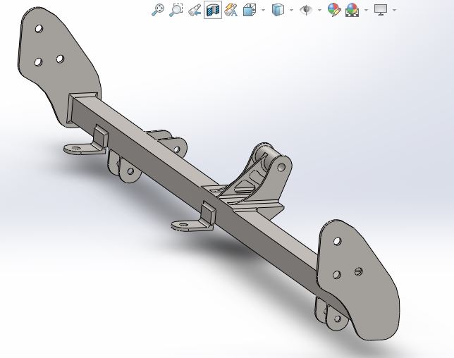

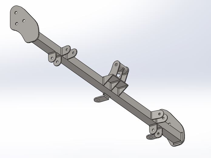

Since deciding on an engine, mounts and new front cross members have been designed.
Front Cross Member:
Attachment 30206
Attachment 30208

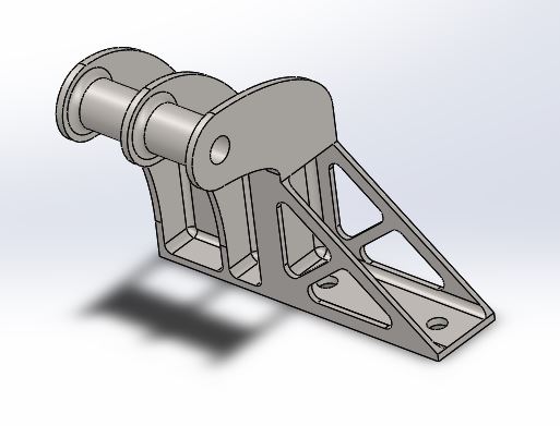

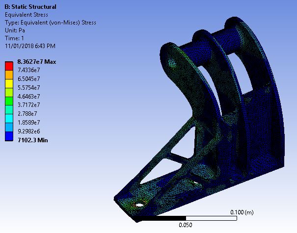

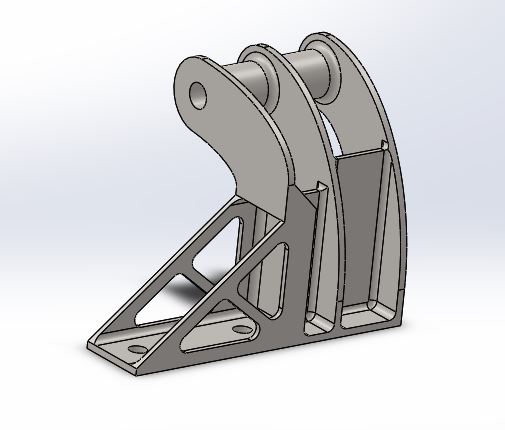

Passenger Mount:
Attachment 30207
Attachment 30209
Attachment 30210
Designed and FEA'd ready to go, start manufacture tomorrow
