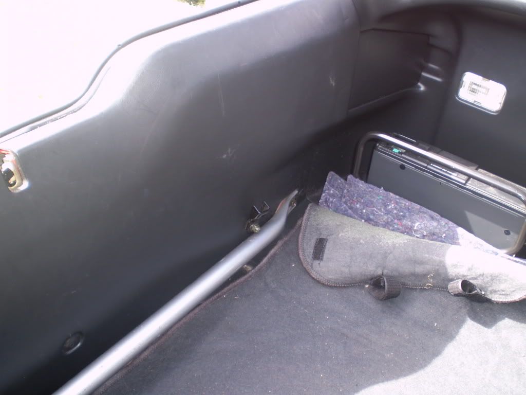

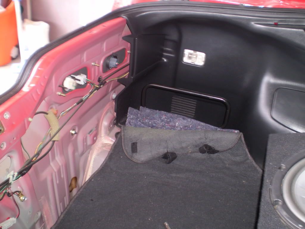

Anyhow 1st you need to take out the back n rear left panels, they have pop up screws so locate then and push them in and they should come out. If you have an ITR ur gonna have to remove the rear bar first. Then take out the boot light, take out the shockies cover and and undo those bolts (i only did this so that i could get my hand in behind the left panel) Do not take out all of the left rear panel as its not necessary. you can if you want to.
http://i119.photobucket.com/albums/o124/mezits/2-2.jpg
http://i119.photobucket.com/albums/o124/mezits/4-2.jpg
http://i119.photobucket.com/albums/o124/mezits/5-1.jpg

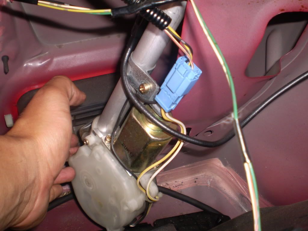

Once you have taken the rear panel off and have enough space to get to the antenna motor, locate the screws, cant remember if its two or one, and loosen them.
http://i119.photobucket.com/albums/o124/mezits/6-2.jpg

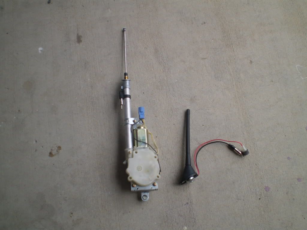

Compare old antenna with SK2 antenna
http://i119.photobucket.com/albums/o124/mezits/9-2.jpg
Fit the new antenna in, you're gonna have to screw it on as tight as you can. i did it by hand as i couldnt get anything to fit, still it hasnt come off.
Also from the previous pic you'll see a red cable with a white housing. i cut the cable as there is nothing to plug it into and its not needed (to the best of my knowledge on the DC2) plus it wont fit through the whole if you leave it on.
