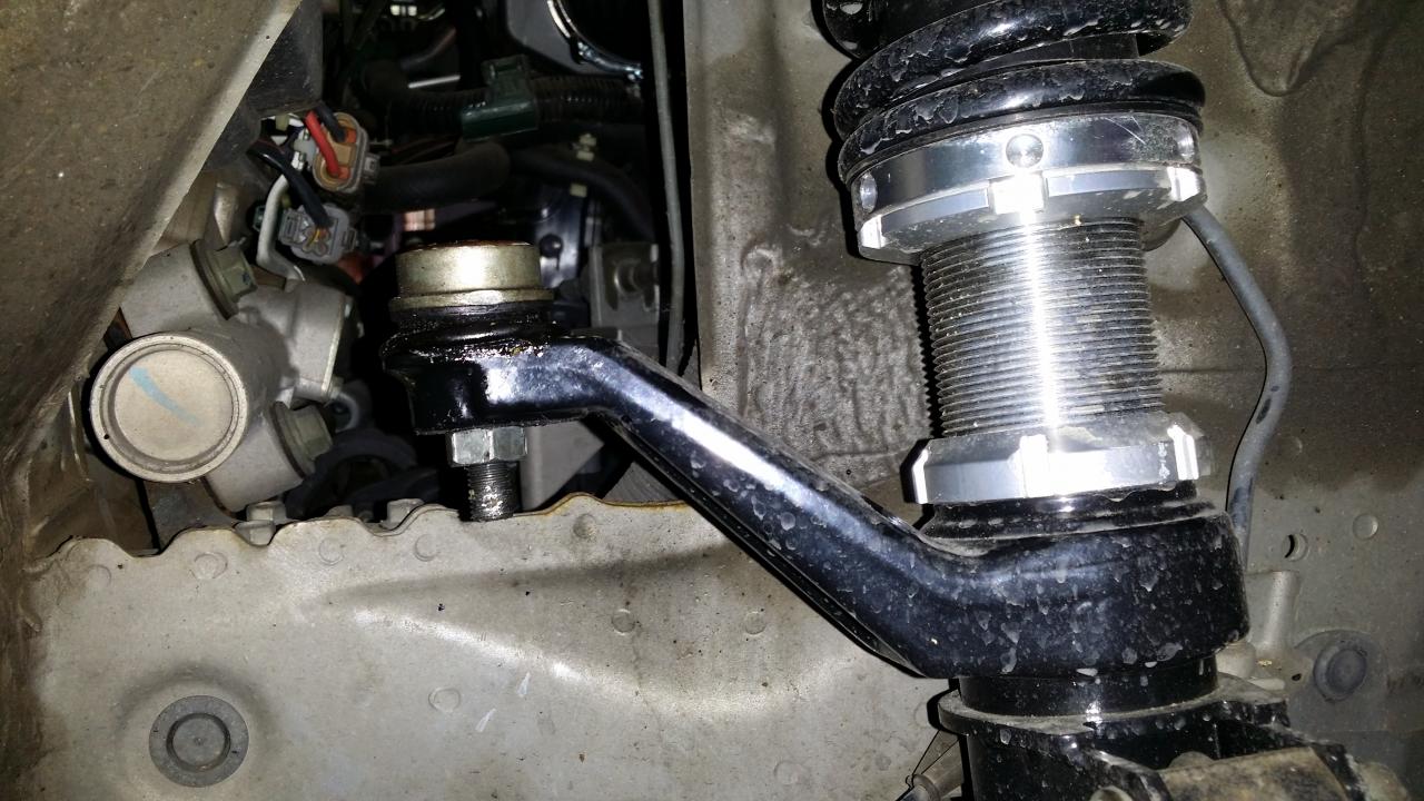

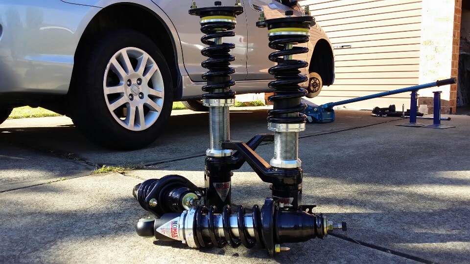

[ATTACH]Attachment 27076[/ATTACH]Attachment 27075
I fitted coilovers on my 2005 civic hatch and have an issue with outer tie rod end.
The hole for the outer tie rod end on the coilovers is bigger than OEM which causes the outer tie rod end bushings tear away.
Was told from shiftperformance that DC5 outer tie rod end will fix this issue.
Can anyone confirm please?
