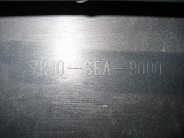

I don't have any boxes! This is an example of what I am reading - it is imprinted in the plastic of each item (on the inside). So this isn't the part number? You guys in parts must be driven crazy if something like this isn't considered a part number... :D

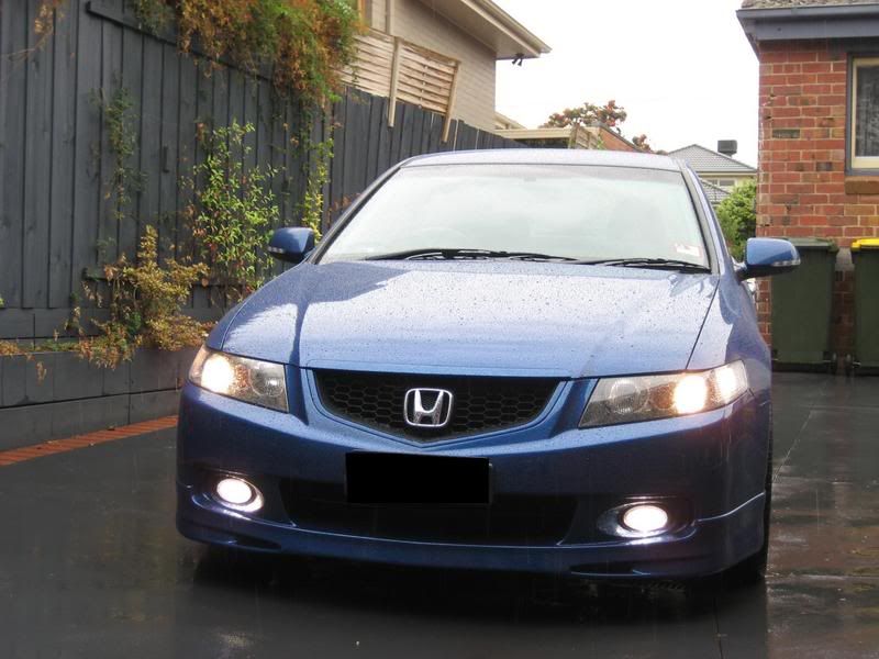

Well I got the kit on - no major dramas, it just took time. There are so many bolts and clips on the kit it is really surprising. Fitment is perfect (I just need to adjust the screws on the bonnet trim - it isn't sitting flush at the moment - didn't notice this until I got the car home).
We ended up using the stock radiator panel cover and just cut out a small section with tin snips to make it fit properly. The Euro R radiator panel cover is not required if someone is intending to fit this kit (or the mugen grill). So save yourself $50 and just modify the stock cover.
We also installed in the bumper a mesh to cover the entire air con condensor (from Bunnings - it is called Tough Screen and made from aluminimum - cost about $12). This product is really strong and will protect the condensor from damage. I recommend this mod to all of you as my condensor has quite a bit of damage from stones and it is quite possible a stone could pierce the condensor requiring a complete replacement (at significant cost - much more cost than a radiator).
I also did the fog light conversion H11 to H9 - great results for only $12. I will be posting up a DIY later. Highly recommended to people with fogs if you want brighter fog lights. You can see even from the daytime photos how bright the fogs are.
Sorry about the crap pics - these are just rainy and dreary. Car is also very dirty. Better photos another time.
Note no Euro R badge! lol ;) I'll keep it that way
