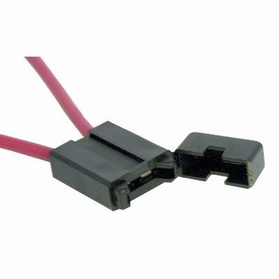

I did it on my FN and FD...
FD is different cause on the FN you just tap into the glove box light...
For the FD you have to tap into the fuse box with a fuse tapper it clips on the normal fuse and goes inside the fuse box you buy them from repco...for a couple of bucks... thats how i did mine there is prob another way...
only took like 20mins..
Had a pm to what the tappers are.. just incase you want them here is a pic and a link to buy them on jaycar.com.au

how do u actually install those fuse tappers ld mart?
