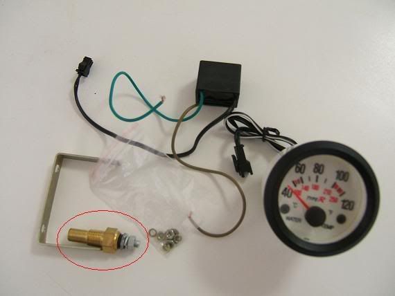

Do you think you could drill a hole through this plug and put the sensor in there:

The part circled in the pick is the sensor:
http://i99.photobucket.com/albums/l2...DSCF1629-1.jpg
are you trying to put a temp guage in you gbox?
Yeah i have seen a sump plug drilled to fit a sensor before, but i dun think i have seen a temp sensor on an auto gbox before.
Yeah,That sounds promising if it's been done before.It would be easy too cause ya wont need the car.I would just take it somewhere and get them to do it for me because I would want it welded around the top to get a perfect seal.
I figure get the sensor in there first to see if I really need to install a cooler or not.If the gear box goes at least I could use the plug/sensor again :)
