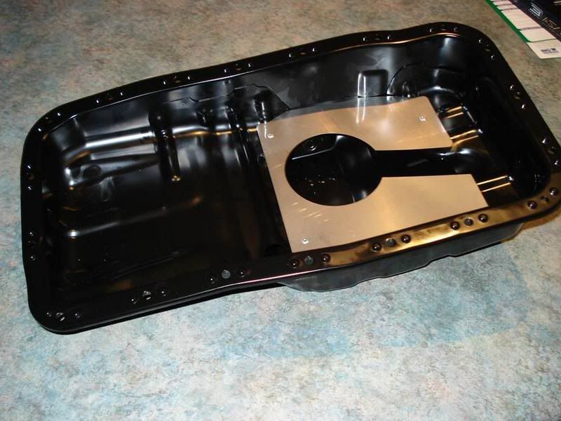

No no no, Ben. East west engine. Baffles are side to side me friend on B18C7. :cool:
This is a b18c7 sump here. Yes it has a 'added' baffle plate, but you can also see the stock over hang baffles (where the plate is rivited on to) These light overhang baffles are stock. East/West engine. Side to side baffle, protecting the oil pickup.
