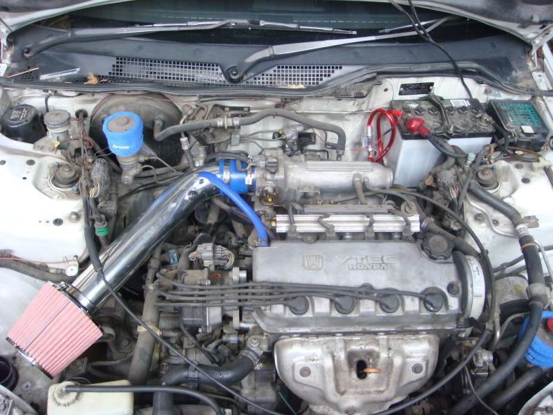

you asked about mounting the front strut brace ... here goes:
the bolt points in red are the stock 'chassis brace' mounting points ... there are NOT to be confused with how to mount a 'strut brace'
chassis brace only connects the top of the strut towers together ... not the actual struts themselves
the bolt points in yellow are the actual shock/strut mounting points ... you have to un-do the (14mm or 17mm) nut on the top of these, insert strut brace, than tighten them back up .... simple
make sure the car is on the ground when you do it - not jacked up
