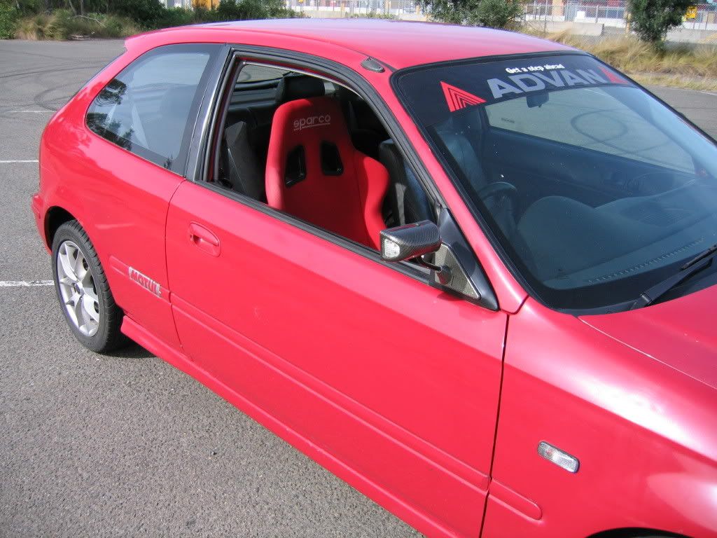

And my baby also scored a Sparco seat along the way. Don't knock the side mirrors. Yes, they are ricey and pretty much useless.

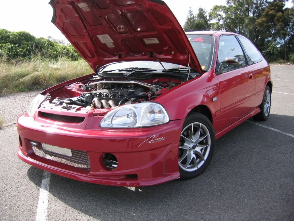

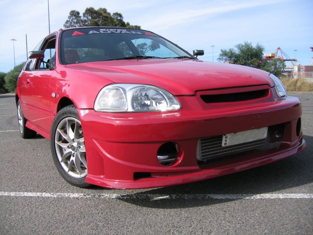

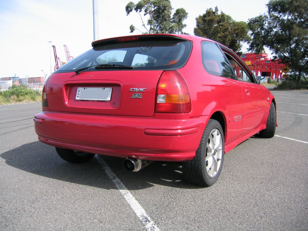

Enjoy the new pics. At least it is not sitting inside the garage this time. LOL.

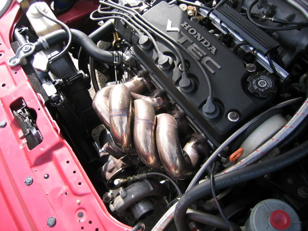

The only thing left remaining from the crappy XS turbo kit is this manifold. Everything else has been ditched and replaced with better stuff. Even the dump pipe is custom made.

Nice one bro :thumbsup:
Red Civics rock!!!
Looks hot apart from those mirrors :p Makes me wish I went with red seats and not black lol
So the eBay kit ended up being a bad chose hey!
At lest this thread shows the downfalls to anyone trying to save a bit of cash by buying cheap eBay kit.

I think its more don't buy cheap made in china kits and no-brand turbos

Turboback stainless steel exhaust $850.00
