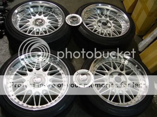

Think i found the perfect set
17X8 +5
17X9 +10
Offset too low !?!
http://i887.photobucket.com/albums/a...0/553133f0.jpg
nah man. thats too intense. you gotta max everything.
I also saw these on NS...
with a guard roll and some stretch + lows and natural camber you can fit them man!
most people go bitch fitment in aus, so step it up and try something unique ;) run a 215/40/17 all round as well.
dudes have fit 18x9.5 +25 so a 9 +10 isn't impossible. it'll only sit out an extra 9mm from that and you'll have heaps more inner clearance to run some epic camber.
good luck :)
Lets hope it all goes to plan....

they will fit tho you will need atleast -3/-4 camber at the front cos that will poke like a bitch and between -4/-6 at the rear. Ontop of that you will need a roll and pull all round + removing the fender liner. As a side note, if this car is ur daily i wouldnt run that hard.. you will go through tyres like condoms at a brothel.. :)
if its for weekend, than woo you hard work will pay off, you wont look back.
yeh bro if its weekend, go crazy on it!
