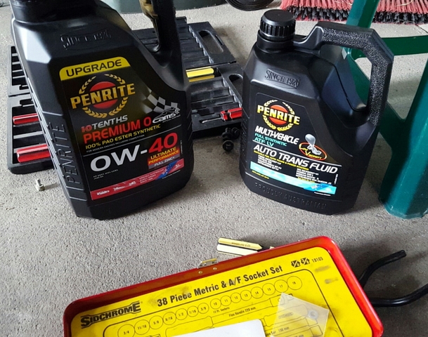

I ended up buying PENRITE LV for ATF & PENRITE 10TENTHS PREMIUM 0 0W-40 for the engine oil.

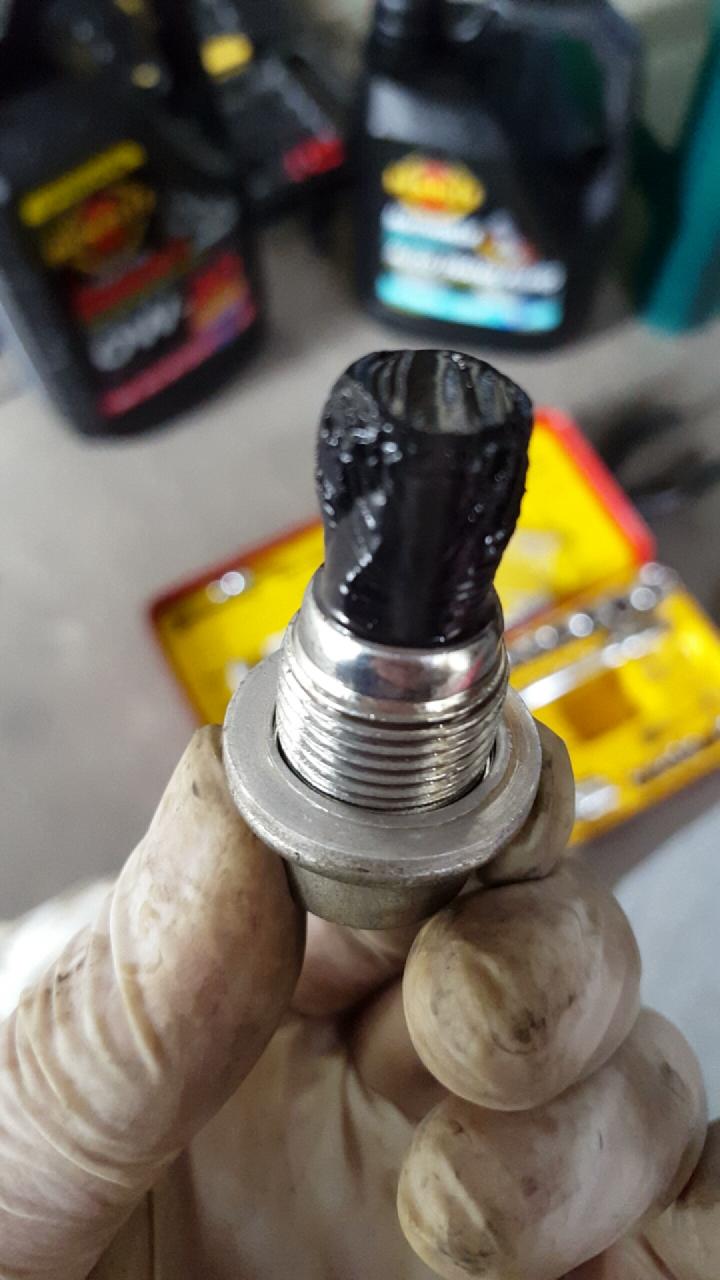

The gunk on the magnet of the bolt looks like it needed a a ATF change after not having one since new.
I will do the 2nd drain in 20,000km time from now

Please let us know how the car goes.
I am sensing that you really want to look after your car with good oil selection but still being sensible and practical. Thanks for the photos.
Yeh thanks mate, really want to look after this car hence the penrite bottles.
