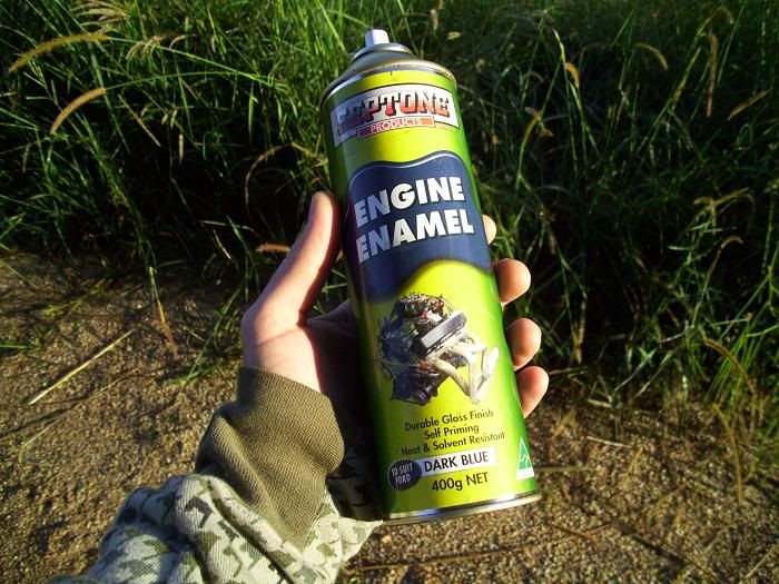

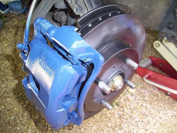

'Dark Blue',as the first light of the day hits the can!

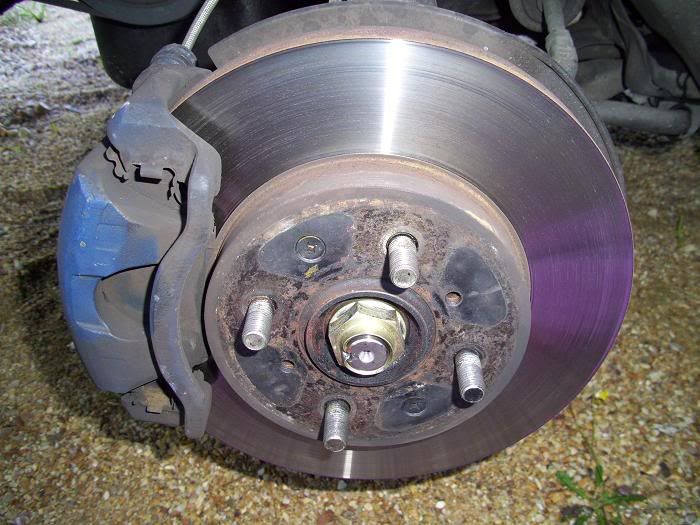

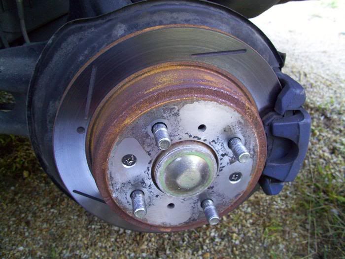

Before:

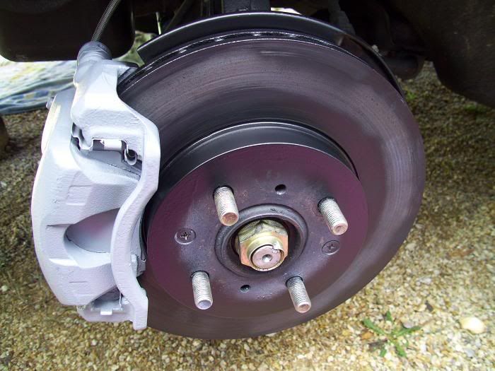

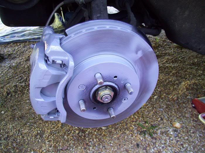

Progress pics:

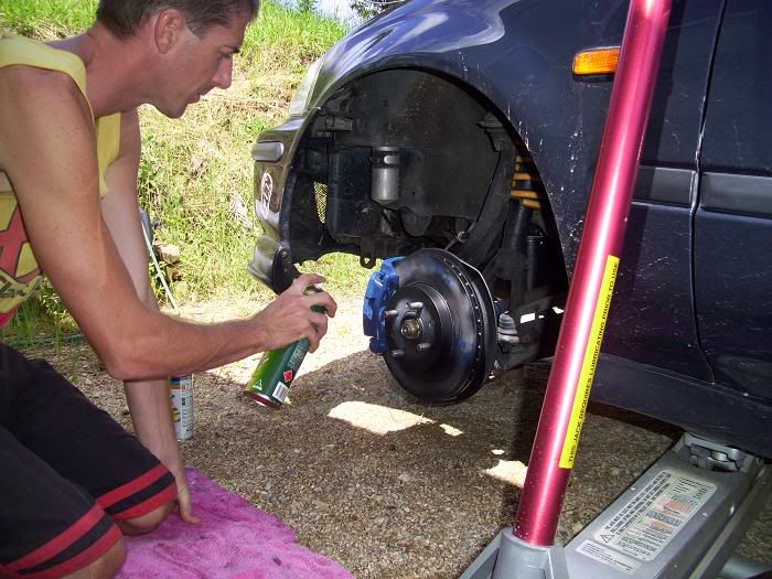

In action! lol

Is it dry yet?
http://i99.photobucket.com/albums/l2...2/100_2509.jpg

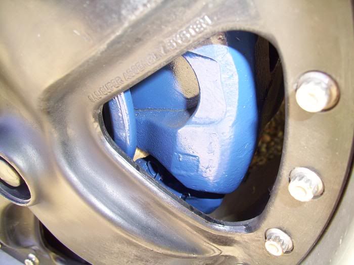

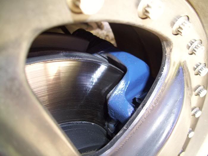

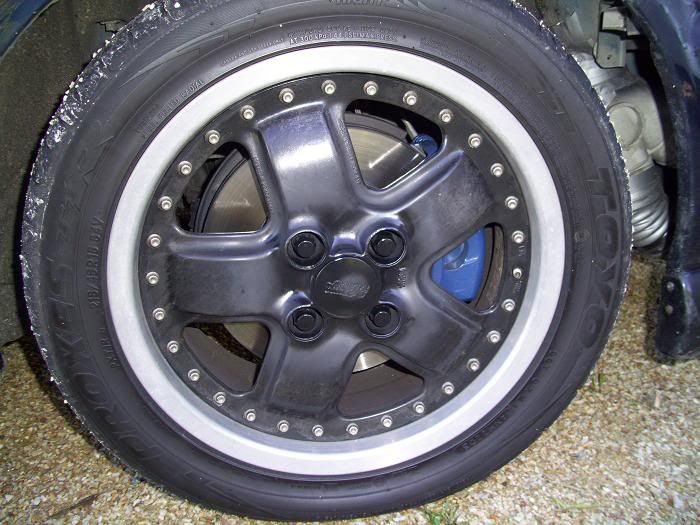

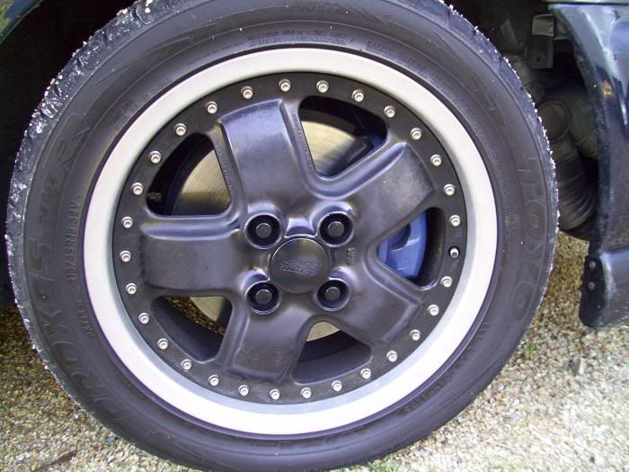

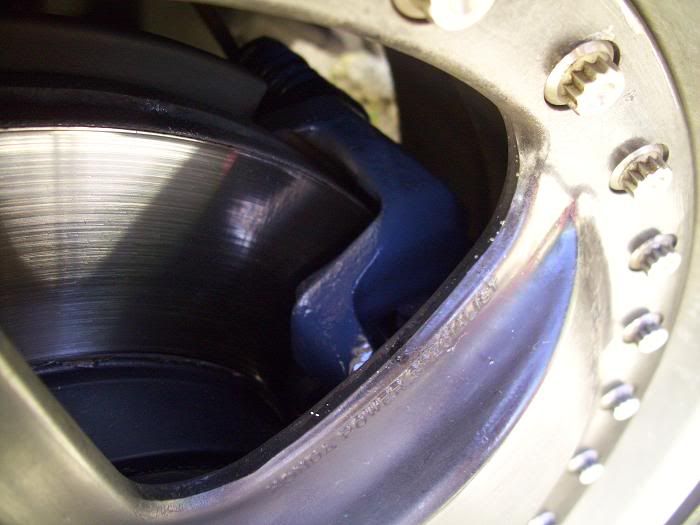

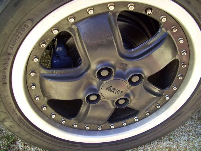

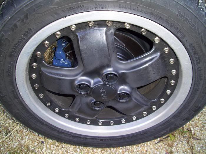

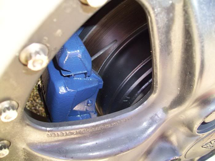

Yup! Photo's with and without flash.

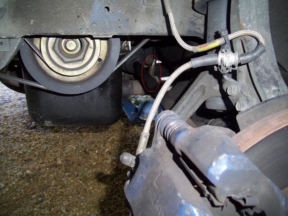

My braided brake lines were hitting the tyre so I cable tied them:
http://i99.photobucket.com/albums/l2...2/100_2490.jpg
http://i99.photobucket.com/albums/l2...2/100_2491.jpg
The circled part is the 02 sensor.That's where U want it - where the 4 goes into 2 then into 1 pipe - The collector.
A lot of people's 02 sensor is hooked up to 1 or 2 cylinders,that will give a false reading and cause ya car to run 'not as good'.
Get an exhaust shop to weld on a 'bung',like where it is above and extend the 02 sensor wire and enjoy a smoother ride.
