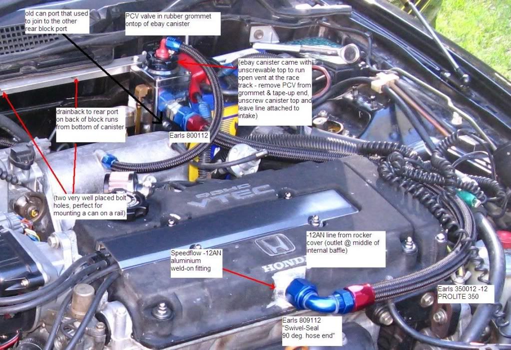

this is how i do it (2.5MB):
http://i913.photobucket.com/albums/a...ankventB20.jpg
you can see a breather filter on the rocker cover, but i actually run the OEM line from the intake pipe to the rocker cover...
Thats a balling breathing set-up
thank tinkerbell...
I know how to run my breather kit now
