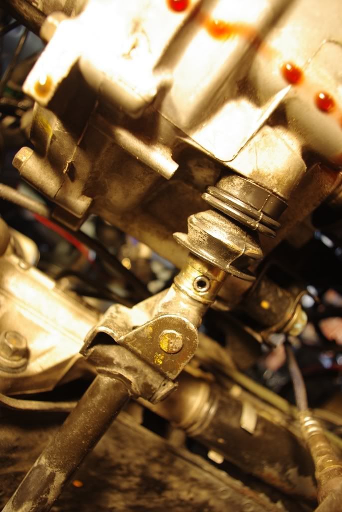

Ok do ive pretty much removed everything needed and im about to put the jack on it and unbolt the mounts but i cant get the shift linkage off?
I remember the last time i did this i ruined it and had to buy a new one is there any special way?
http://i101.photobucket.com/albums/m...c/IMGP3391.jpg
8mm punch + hammer usually works, but I find it easier to just remove it from the shifter end =]

Cheers guys, I'll give that a go.
just remove fromt he shifter end and do it away from the car where u can access
from all angles if it makes it any easier...
i recently did this too... that the way i removed it... used a 8mm bolt...:thumbsup::thumbsup:
