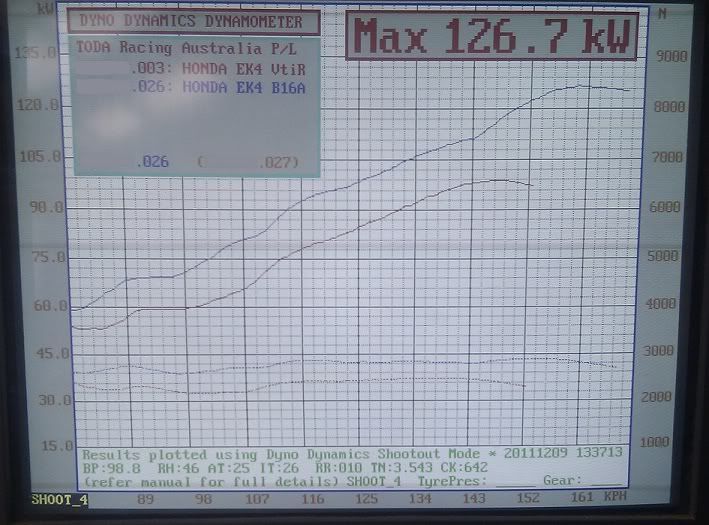

Rev limit - 8800rpm
Vtec Swap - 7300rpm @ 85kpa / 7500rpm @ 40kpa
The high swap is becasue it makes more power on the low cam till then
- see dyno sheet below
Idle speed - 950rpm
I was wrong with the output too, it was actually 126.7kw, not 124 - sorry
Dyno sheet is before:& after (Stock vs + Headwork, headers, cams etc & tune)
The change in description from VtiR to B16A is just me typing something different on differnt days, but it's the same car
