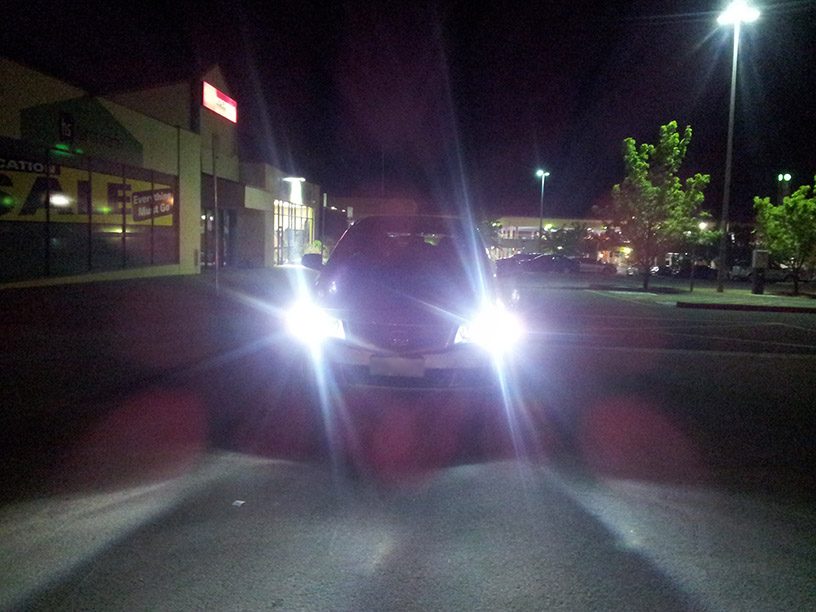

HID lights are available in different color temperatures, ranging from 4300K to 30000K. The lower the temperature, the whiter and brighter the light, the higher the temperature, the more blue or purple and dimmer the light. 4300K are the color temperature of OEM bulbs. Over time as they age, their color will shift to closer to 6000K
I chose 6000K as a good compromise of brightness and color. It is a bright white blue color (similar to the color of the car!). It is quite a bit different from the Sylvania bulbs that come with the car.

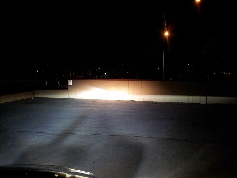

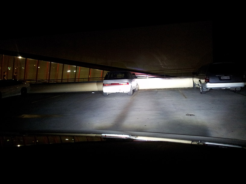

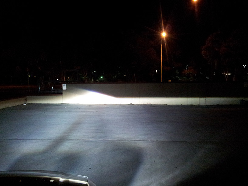

How do they perform? Very well, the Civic headlight reflector design seems to be able to handle the new bulbs with little to no glare, or other undesirable effects. I have had no one flash their lights at me, and have actually driven in front of the Civic with one of the my other cars to see how it looks from a rear-view mirror. The lights top-cutoff is very good, and the effect is no different from any other car with Xenon lights.
