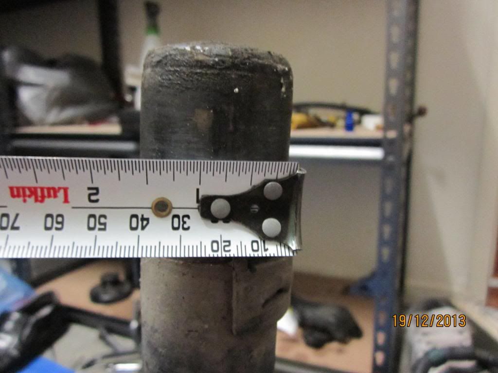

I busted out the cheapo canon camera that i bought for the garage for photos and took measurement photos of strut and hub.
now i tried to fit the vti hubs and shocks to my car when i wrecked it and the hubs were well off. the bottom ball joint bolt was much smaller on my car.
so i bought some ef shockies and again the ef shockie is too small to fit in the hub......
here is the mesurements if somone could mesure some shockies from a 90 model accord would be great! or know of any shockies that are a bit thicker?
http://img.photobucket.com/albums/v4...y/IMG_0309.jpg
http://img.photobucket.com/albums/v4...y/IMG_0308.jpg
http://img.photobucket.com/albums/v4...y/IMG_0306.jpg
http://img.photobucket.com/albums/v4...y/IMG_0304.jpg
The problem you have there is that the City's setup is a true MacPherson, and the shock shaft is also part of the steering assembly and is normally a bigger diameter shaft to withstand cornering loads. The later civic, accord etc shocks don't have that stress put on them as they connect via the yoke around the CV shafts to the LCA. What you will need to look at for alternatives is the ones from the pre 87 civics/crx's or accords as they are the same type of setup. The Gen 1 Integras could be a better bet.
I have to apologise, I gave you a bit of bum info there. The only one of those earlier models that used coils similar to the GA2 is the pre 85 Accords (and possibly the Preludes which generally were Accord based), all the others used torsion bars connected to the LCA and therefore used a shock without a spring seat but still did have the thicker shaft. Could be worth looking into because it may be possible to make up a sleeve type lower seat that would fit over the shock and bear against the outer edge of the knuckle (your last pic). A custom top seat may need to be also made for the coilover spring. As it's a tracker you wouldn't need to be too worried about a rubber insert.

had a massive look around about it bought shocks from every model accord none fit :( so its either coil overs custom made or springs and a rebuild.

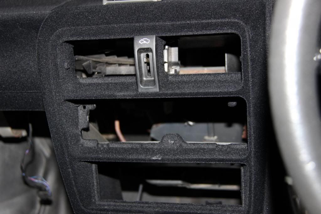

this are slowly taking shape. (i through it all back together really quickly i might add nothings set in properly and its just sat in there to get a photo for all to drool over.....)
http://img.photobucket.com/albums/v4...y/IMG_0217.jpg
http://img.photobucket.com/albums/v4...y/IMG_0219.jpg
http://img.photobucket.com/albums/v4...y/IMG_0221.jpg
http://img.photobucket.com/albums/v4...y/IMG_0224.jpg
http://img.photobucket.com/albums/v4...y/IMG_0223.jpg
http://img.photobucket.com/albums/v4...y/IMG_0220.jpg
All of the flocking was done by gold coast flocking and i cant recommend his work enough

That's a flocking good job! Ya gonna get the door cards done too? Hope you can find the triangle to cover the mirror screws.
