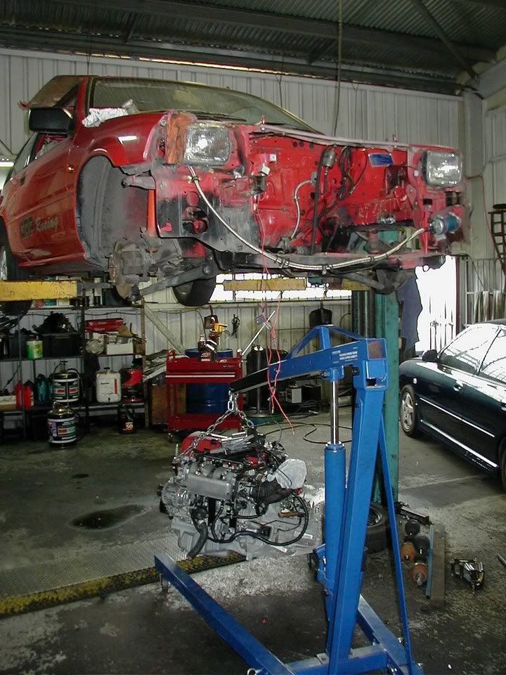

Heres a progress pic (although not very exciting)
http://i22.photobucket.com/albums/b3...h_pic00202.jpg
next one will be of the engine in car!

what are you going to do for axles? can something std Honda bolt up?
Chuck: Yes, very very disapointed. :(
Jim: Shortening both standard k20a shafts to fit for now. Will end up running billet axles sooner or later. Will give you a call in a few weeks about parts and a few other things. :thumbsup:
hey mate. a guy over on k20a.org has figured out a way of using the stock axles.. even for the 32mm... the only problem is its for an EG, but with your car it may also be possible, it'd be worth looking into anyway. This would be alot cheaper yet just as strong as some of the billet axles.
the way it is done is by custom fitting b-series axles to k-series axles.
