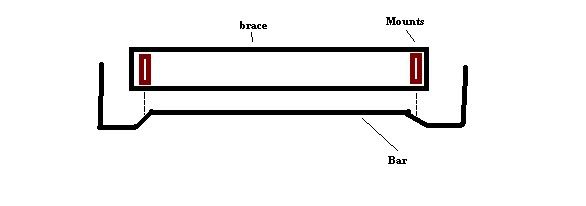

The issue is that with whatever bushings, with them mounted to the asr brace, the points where the bar would sit in the bushings is actually not a straight bar. There are two small bends, at the same spacing apart as the bushings on the asr brace. And as im certain your aware, the bar needs to be parralell to the hole throught the bushings.
Whiteline designed for the bushings to sit 2-3 inches further apart than the asr brace allows, the only option would be to have the bushings further together, or further apart, to clear the bends, so only straight bar is running through them.
For example:
http://i106.photobucket.com/albums/m...87/zzzzz-1.jpg
See here, the only way for me to mount the bar to the brace was to space the bushings further apart then the mounting holes on the asr brace, with the bushings closer together, there gonna be right where those little bends in the bar are located.
http://i79.photobucket.com/albums/j1...7/IMG_1768.jpg

Wat you need to do, is find somone whos recently brought a 22mm whiteline bar for your car, shouldnt be to hard.
Ask them if those two small bends are in the bar, if so, no go.
Im guessing that when whiteline decided to design a heavy duty mounting system, they changed the bars design aswell to make it compatable with the popular ASR brace. Hence why ricer had no issues with compatability.

Thats weird, did your bar have those little bends that line up with bushings mounted on the asr brace?
