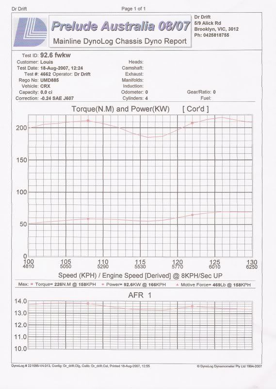

just had mine on the dyno over the weekend
put out 92.6kw@fw, using BP ultimate
mods are
-CAI
-xforce headers
-JDM eg6 cat
-custom 2.5" catback
not a bad result imo for a car that has 210k on the clock and is reltatively stock

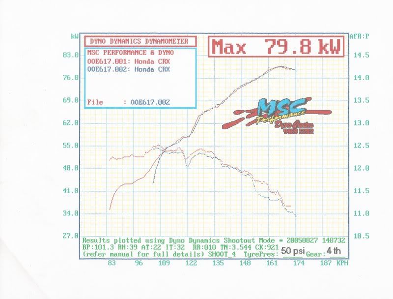

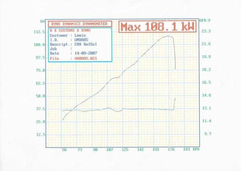

just tuned my crx using greddy emanage blue
mate of mine named Cihan Aday did the tuning using RE Customs dyno, u can find his website here or in my sig
mods are xforce headers, JDM eg6 cat, custom 2.5" mandrel bent cat back, and fujita CAI
very happy with the results more than i expected out of a relatively stock b16a2:D
before mods
http://i29.photobucket.com/albums/c2...7/SCAN0004.jpg
after mods
http://i29.photobucket.com/albums/c2...SCAN0003-1.jpg
after tune
http://i29.photobucket.com/albums/c2...ol87/after.jpg
Nice result.
fark louiey
such a hoon wif all that power
im very impressed as well with the ouput of b16
yeh man not bad for a n/a 1.6, with just I/H/E and tune
hmm imagine u had some crazy quality headers. =D more poweeerr ahaha nice results but for the mods u have
Have to agree, X-force headers are bang for buck. Good for stock motors.
Very nice result there. Time to hit the strip and see it pulls.
wow nice tune, the a/f ratio is like so straight :O
hmm 108.1kw looks like i'll need a tune soon
can't wait to see what waggy gets thats things gunna be a weapon
just needs someone reliable to tune it. LOL and not to you waggy.
my tuner rekons i can pull bout 120kw@fw if i get a IM with short runners and a 70mm TB and another tune
oh and btw Cihan is willing to travel interstate to tune cars, his headed to bris this friday and tuning a couple of soarers, if anyone is interested in getting their car tuned by cihan have a look at his website (can find in my sig) or hit me up with a pm
wat kinda dyno is it running on? cuz 120 is heaps for a b16 imo
thats 40hp ATW more than my b18c..
Same power as my B18c with 7psi of T3/4 boost goin iin it...
low 13sec machine you have there
VERY IMPRESIVE
its just an estimation proECU, not claimin that with the intake upgrades my car will make 120kw@fw

was the last run in shoot out mode it doesnt say at the bottom
and why different dyno's every time? if i was you i'd take it back to the first place now and have them dyno it again.
Your car had 92.6kw with only mods and 108.1kw tuned thats a 15.5kw increase from tuning alone. Thats very impresive maybe i should follow your build.
my ek4 with 200,000+kms made 108.7kw with only I/H/E ask your tuner if he thinks the same method will work for me because as the theory goes with a new IM, a 70mm TB and a tune from your friend i should end up with hmm 108.7kw+15kw+11kw= 134.7kw
Your 108kw abit unrealistic IMO..... If its true your motor making 108kw atw when you go outto drags again your MPH should be around 94-98MPH.
