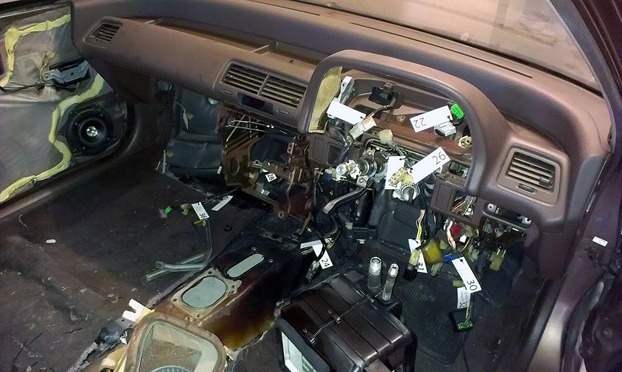

took more of the dash out, along with a lot of sweating

I wouldn't advise removing deadening. It's horrible to drive in. The firewall deadening weighs a lot but the floor deadening doesn't weigh that much
How much did all the deadener you removed weigh?
