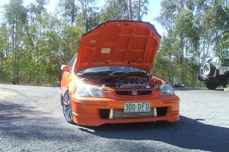

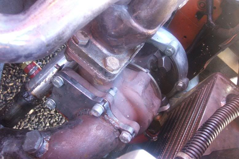

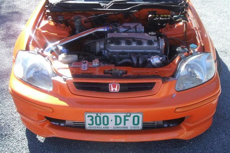

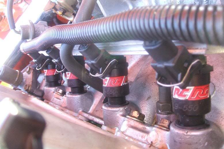

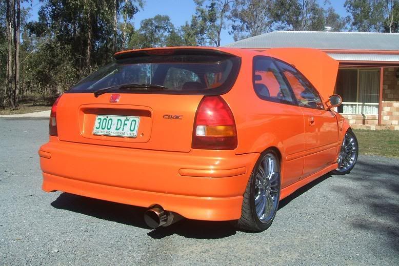

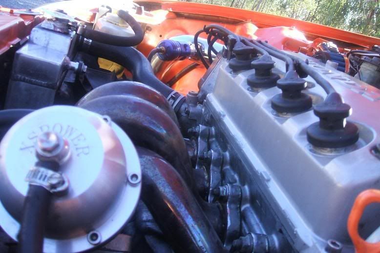

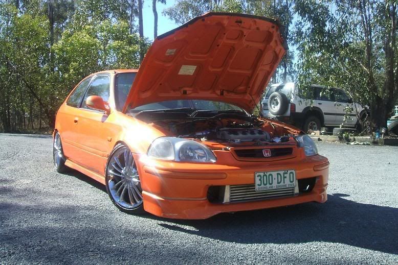

ok got some pics finally
http://i27.photobucket.com/albums/c1...seready002.jpg
http://i27.photobucket.com/albums/c1...seready006.jpg
http://i27.photobucket.com/albums/c1...seready007.jpg
http://i27.photobucket.com/albums/c1...seready008.jpg
http://i27.photobucket.com/albums/c1...seready011.jpg
http://i27.photobucket.com/albums/c1...seready003.jpg
http://i27.photobucket.com/albums/c1...seready004.jpg
looking good meng :P :thumbsup:
me thinks some angle eyes and some ek Series 2 tail lights, Red and Frosted clear (not Red and orange)
clear indicators y0!
i'd do rims and tail lights and thats about it
