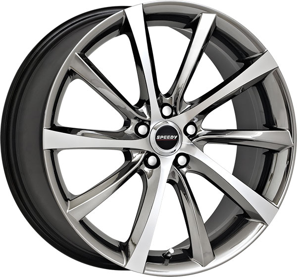

I've been eyeing up these wheels:
Attachment 20320
They're Speedy Revolvers.
They come in 18x8 with +45 offset and 114x5 bcd.
The factory wheels are 17x7 with +55 offset so the new ones at +45 should be almost flush yeah?

The specs of the rims is fine and is almost flush to the fender, not too sure about using 235 tires though. I would be more confident they would fit if it was 225 tires.
i have seen people fitting 245 on RB3 but not sure what offset they had.
18x8 +45 should be flush at the front but you will need something like +38 to be flush at the back.
