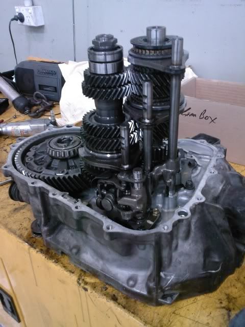

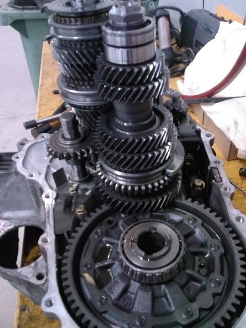

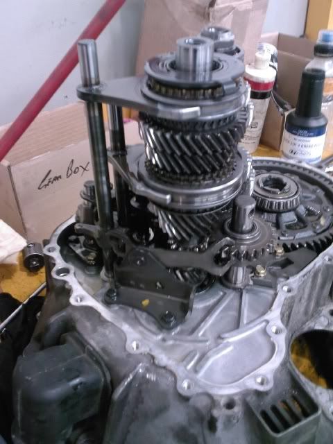

Finish work early today so i decided to rip the dearbox apart, everything looks fine going to replace the main bearings, diff, input and output bearing. I went to CBC bearings try to match them up F@$k no joy looks like i got to order them from Honda!!! so more waiting to do, i was hoping i could get the bearing matched up and put it together today:(
Some pics for use guys forgot to take some more photo will 2moro

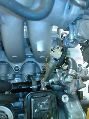

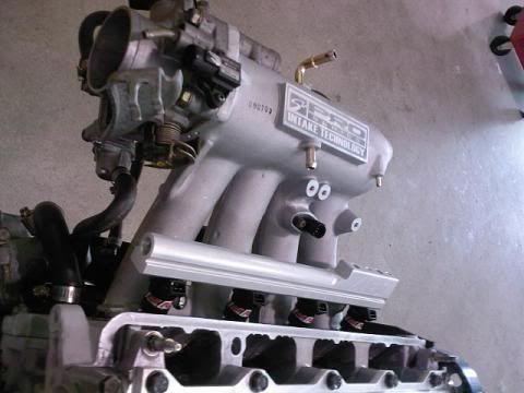

Hi everyone, sorry havnt been updating on the project i got my motor backs and been busy putting it back together now i need some help!!! can anyone (pros pls no noob plz) I have installed the head, new water,new oil pump, timing belt, BC cams, skunk2 manifold. Now the problem is there this breather box??? behind the block which has a pipe that goes to the OEM manifold which the skunk2 dosnt have. Can anyone help me out THANKS!!!
http://i241.photobucket.com/albums/f.../Photo0112.jpg
http://i241.photobucket.com/albums/f.../Photo0110.jpg
This is the pipe i have know clue were it goes from here!!!

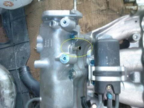

This the OEM manifold where the pipe goes into

Just run that line to a catch can or something. Let it breathe, its to release crankcase pressure. Something you should do when boosted.

that "pipe" , should run to a PCV (positive crankcase valve) , and then into the inlet manifold.
