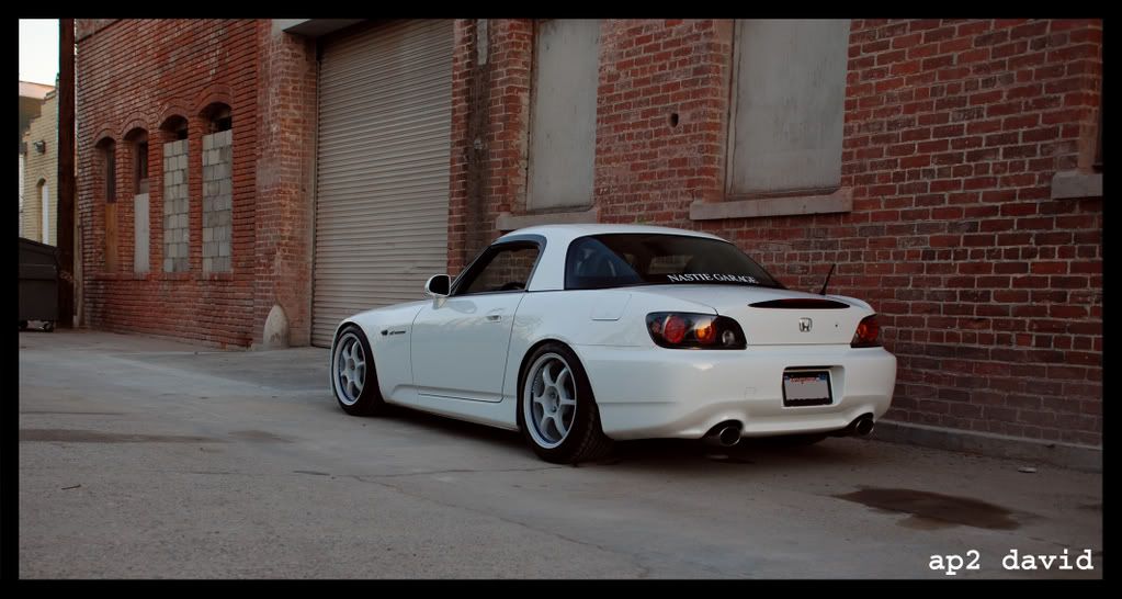

This is 17x9 +45
http://i35.photobucket.com/albums/d1...r/advanrg2.jpg
