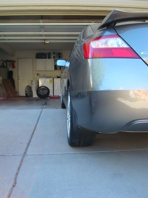

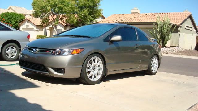

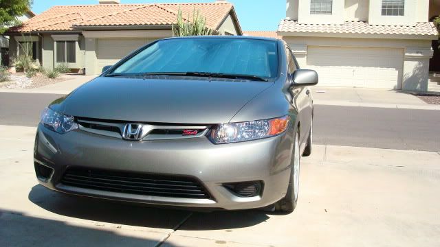

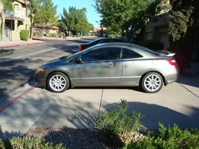

My DD set of rims, STi BBS rims, still with 225/45/17 RE70 tires. Specially machined rims to fit our car.
25mm Spacer front and 3mm rear of course shown here with -2.9 camber front and -2.5 rear.

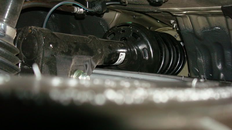

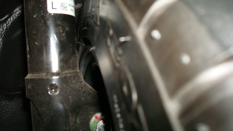

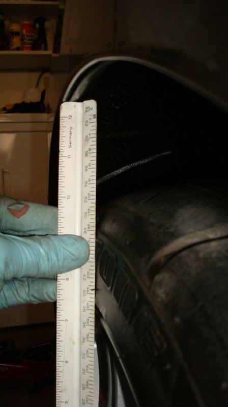

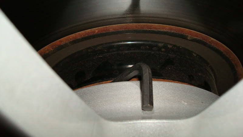

Un-machined wheel: After wheel was sinched up with lugs evenly, there was room for a 5mm allen plus a tad slop. We'll call it a straight 5mm.
http://i121.photobucket.com/albums/o...i/DSC00940.jpg
being that the wheel is already spaced out 5mm from rotor which was bolted to hub, we are left with about 6mm clearance b/t shock and tire. Perfect!
http://i121.photobucket.com/albums/o...i/DSC00942.jpg
http://i121.photobucket.com/albums/o...i/DSC00944.jpg

Rear clearance spaced out 5mm
http://i121.photobucket.com/albums/o...i/DSC01094.jpg

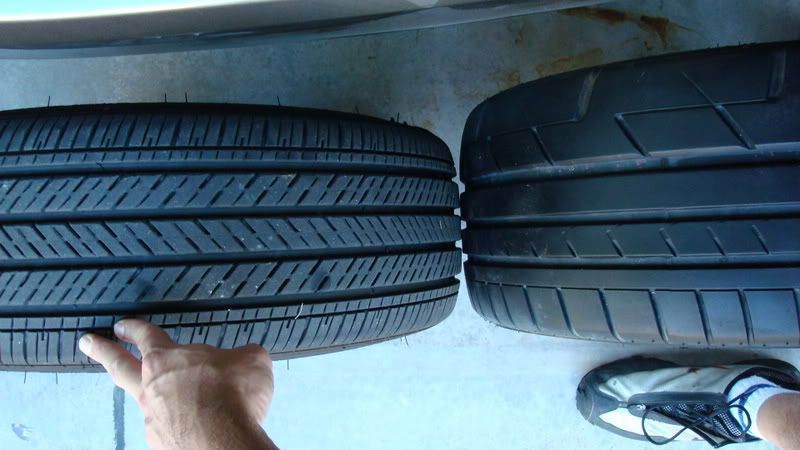

Big diff in tire size although this 225/45/17 potenza RE70 looks to be very wide. Maybe a 235 width.
http://i121.photobucket.com/albums/o...i/DSC00933.jpg

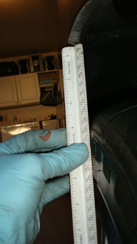

Fender clearance front - approx 12-15mm more room to go out. wheel at approx +48 offset so a +35 offset should work without rubbing
http://i121.photobucket.com/albums/o...DSC01067-1.jpg
http://i121.photobucket.com/albums/o...i/DSC01065.jpg
