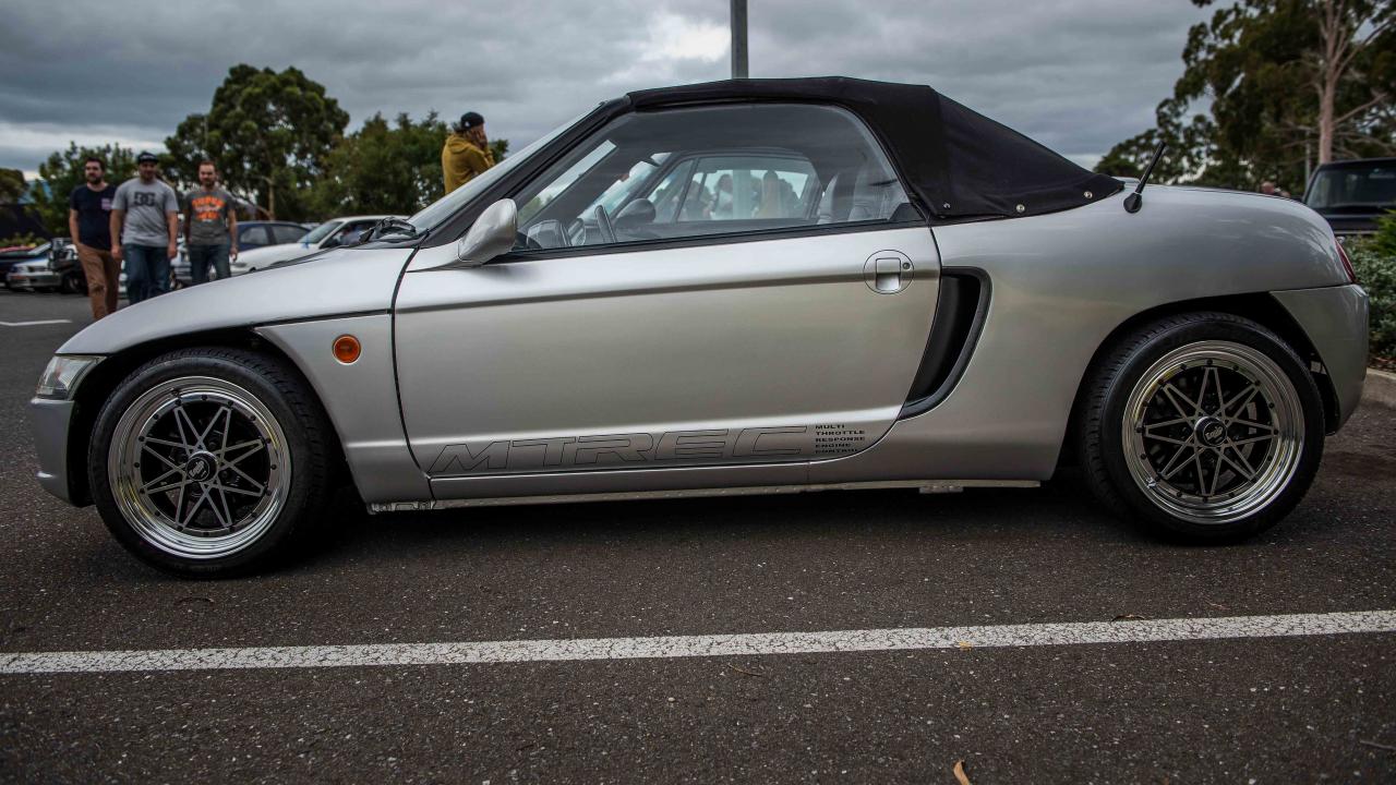

This is my favourite car on all of ozhonda :D
