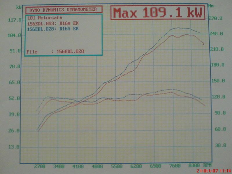

Ok might as well post a graph since I started this thread back in the day....
http://img.photobucket.com/albums/v6...E/DSC00908.jpg
Got retuned last Sat by Dyno Dave... power is alot smoother and the overall partial throttle driving experience is awesome.
The clean up of the X-over point is what made me V happy. Previously it was a pain to keep the car on the boil since Xover was @ 5900 or there abouts...... might have been a different story on how the car drove if I had a 4.7 FD.
Now with the fattened up midrange its dropping me right back in the meat of the midrange when upshifting, so alot easier to drive briskly. From 7000 to fuel cut.... well it speaks for itself.
I'll try to get down the 1/4 once I get the rear mount inserts done....
v.nice :)

the dyno runs should have been done in 4th gear.
If the run was done in 3rd there would have needed to be a conversion done on your result to get it to read correctly. If the converson was incorrect then the reading would be off.
r
it's got on the sheet gear was 3rd i think all the runs were in 3rd
what gear did Mercury run them in?
lol ive lost the Mercury 108.9kw print out just like the power
Mercury Dyno Day, they used 4th gear.
it was done in 4th.
Don't know why these other guys did it in 3rd. Although 3rd would have returned a higher reading which is what makes me think theres a mistake in their calculations or their dyno is rooted.
most likely the Mercury was done in 4th gear that might explain you 17kw loss.
And yes they should be doing it in 4th gear as that is what the general standard is.
In relation to low tyre pressure, as the car gets hotter the tyre pressure will go up and give better readings.
Was it only 1 run?
