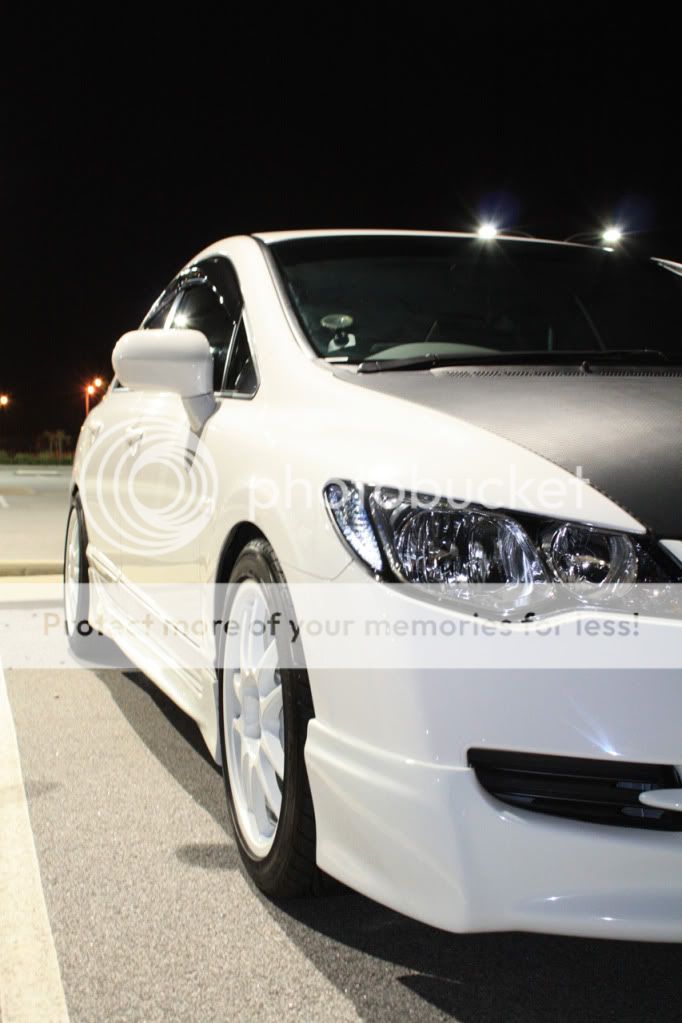

lowered + rimmmin
http://i235.photobucket.com/albums/e...nydny/car1.jpg
+ asssage
http://i235.photobucket.com/albums/e...nydny/car2.jpg
hope u likey
