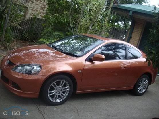

http://i973.photobucket.com/albums/a...30/6113559.jpg
These are the one's .k.
They look okish.... but not for me....
yeah i didnt like them til i saw them on a few FG's in the states, dumped + sprayed diff colour look good
