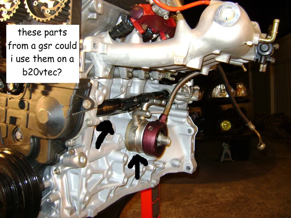

what would you suggest if you wanted to run an oil cooler with the vtec sandwich plate?
it would affect the performance/maintenance of the motor, would it?
any suggestions to this??^^
Bud people have been running the oil cooler and sandwich plate, as long as you have proper gasket to go, i dont see why it should be a problem
here is a pic of a stock b18c oil cooler on a b20vtec + sandwhich plate
http://i717.photobucket.com/albums/w.../backofb20.jpg
im no mechanic so thats why im asking, someone had to right.
i wanted to know if running 2 aftermarket sandwich plates, nothing would fail?
thanks for the above pic
You only need 1... (OEM oil/water heat exchanger + sandwitch block)
If you have an oil cooler sandwith block, you can run the vtec oil supply from this.
Don't stack up sandwitch block on top of sandwitch block, you're asking for trouble.
To use the B16/B18C OEM oil/water heat exchanger you'll need to add a water outlet fitting to the block.
This hole is blank on the B20
