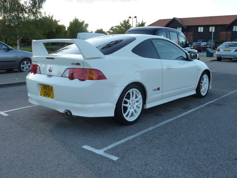

But as senna mentioned, best way is to take a ride in a few different setups, but seeing as you want to retain a closer-to-stock feel, Eibach Pro Kit is highly recommended :)
Here's a pic of a JDM DC5 on Pro Kit. Not sure how different it will be for AUDM DC5r's as stock wheel and tyre combo is different. Someone can shed some light on this?
http://img.photobucket.com/albums/v2...0/P1010593.jpg
http://img.photobucket.com/albums/v2...0/P1010592.jpg
