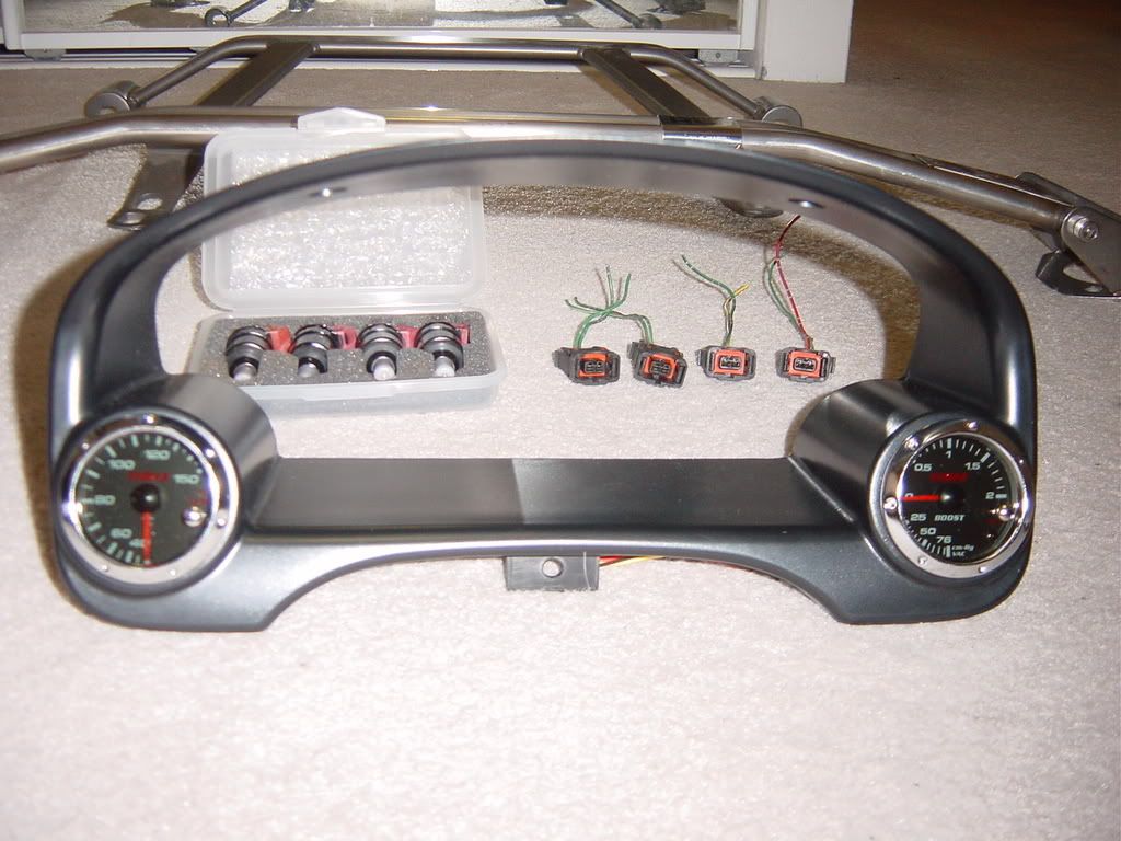

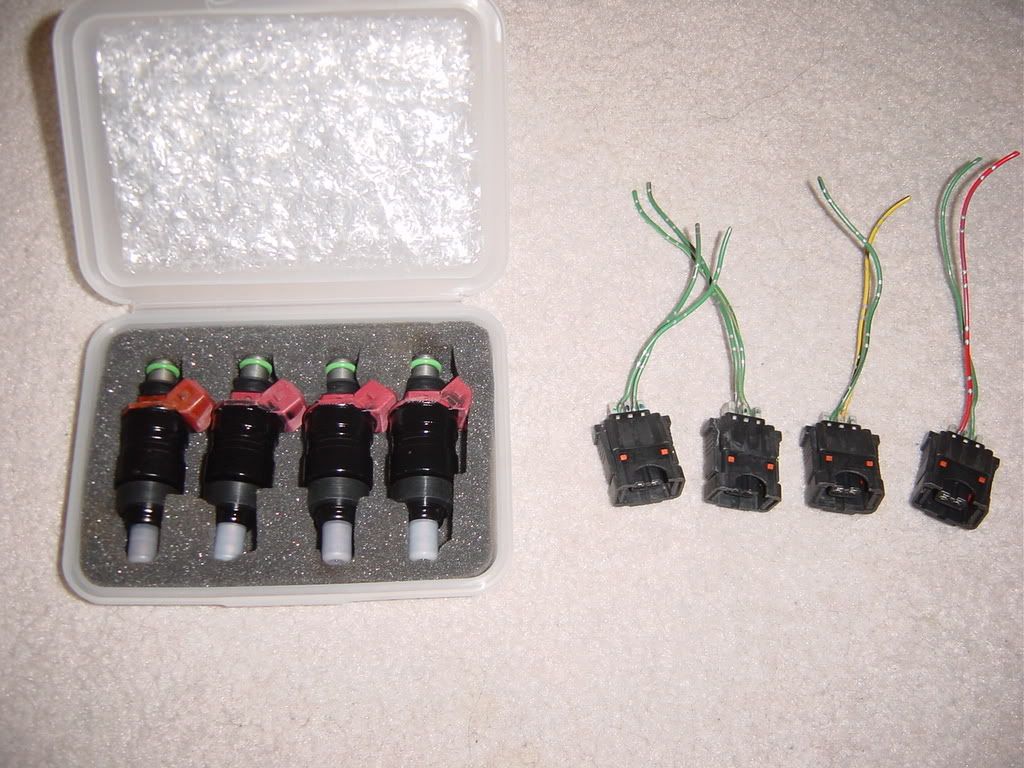

Just want to show you the items which i have included in my cost summary. They are not installed yet. Will do it the same time when I installed the other sponsored items.
Front strut brace and lower 4 points bar

Rebuilt Denso 550cc injectors with OBD0/1 connectors
http://i238.photobucket.com/albums/f...i/DSC01164.jpg
The cluster dash surround and gauges
http://i238.photobucket.com/albums/f...DSC01163-1.jpg
I think they are decent enough for the price. All items arrived from US without hassle.

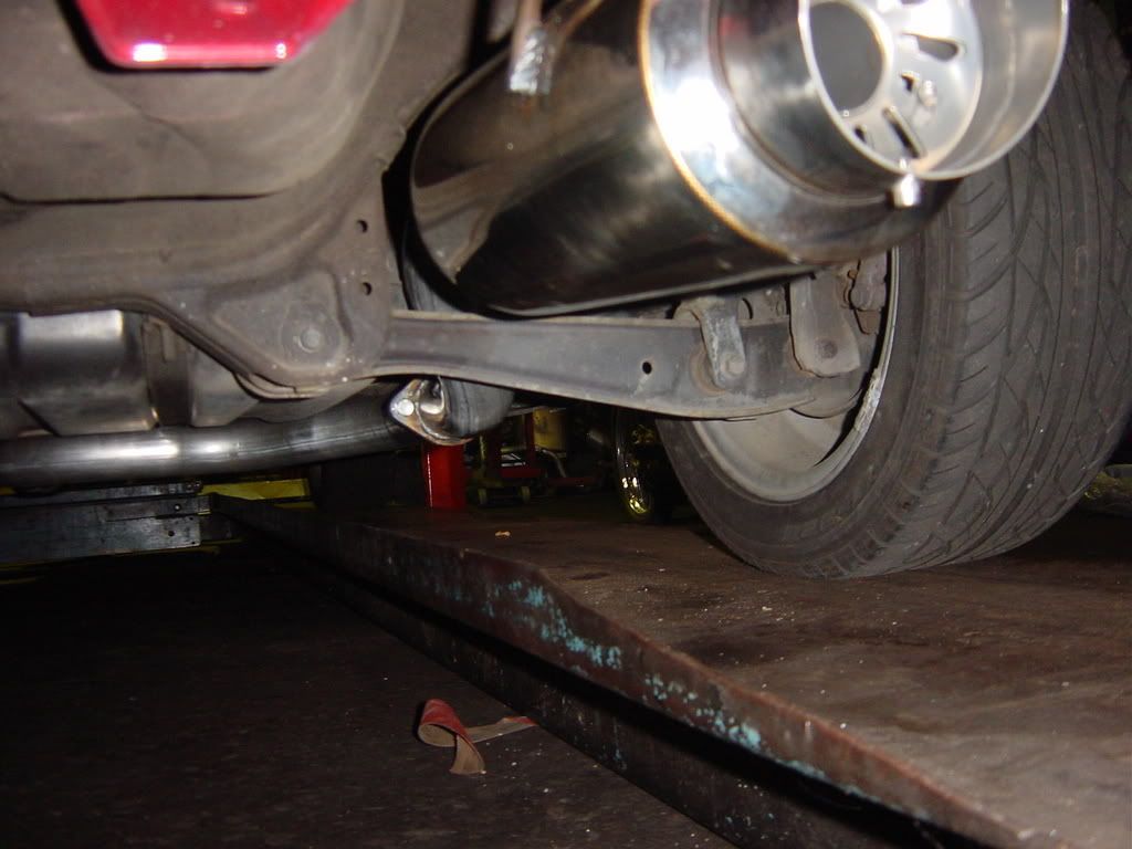

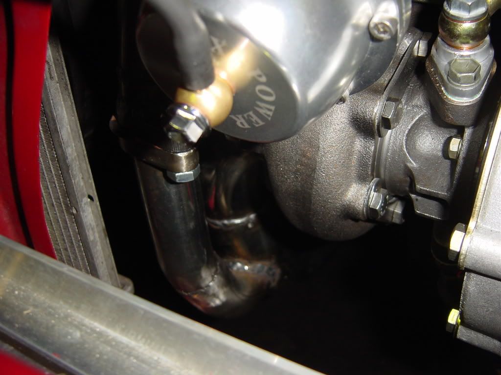

Ok guys...tonight I went to Long Last muffler shop to pick up my civic. The custom catback exhaust is done plus the fume from the external wastegate can now plumb back to the exhaust system. The workmanship seems good. See pic.
http://i238.photobucket.com/albums/f...i/DSC01199.jpg
http://i238.photobucket.com/albums/f...i/DSC01193.jpg

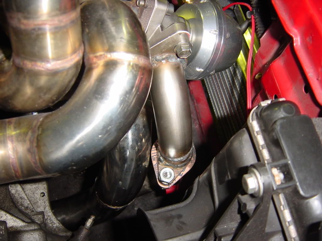

Okay the wastegate is now joined onto the main dump pipe. At least i won't get a $20,000 fine from EPA.
http://i238.photobucket.com/albums/f...i/DSC01197.jpg
Custom exhaust piping from cat to muffler. 2.5" all the way
http://i238.photobucket.com/albums/f...i/DSC01195.jpg

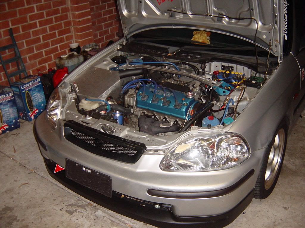

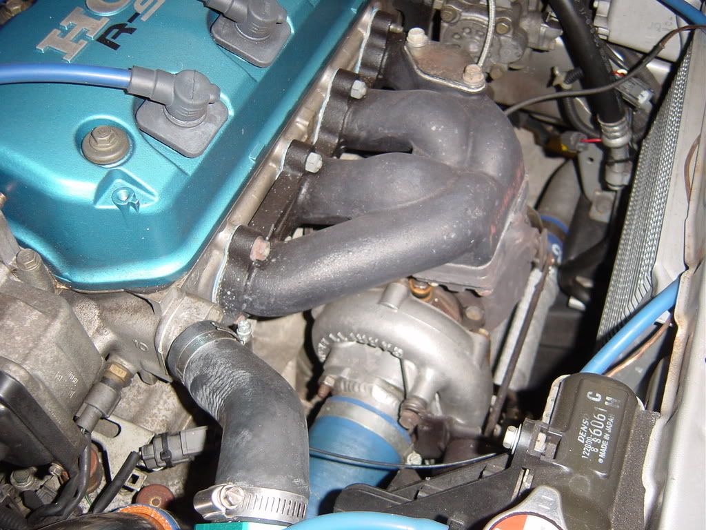

Here is Tim's own personal turbo EK D16 ride with proper custom setup.
Garrett GT28/Disco potato turbo for fast spooling...cast iron header for reliability....custom cold air box...oil cooler...plus more..Lighting Fast!!
http://i238.photobucket.com/albums/f...DSC01189-1.jpg
http://i238.photobucket.com/albums/f...i/DSC01185.jpg
I will discuss more about this car after my project is completed...All I am suggesting is that if he can make this car runs so beautifully then he should be able to sort out mine. Let's hope and he can find the problem of this kiwi civic.
