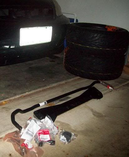

So i decided to get my shit together and get the suspension upgraded on my car and purchased an asr enforcement bar and ek9 rear sway bar and 2 new toyo t1s (cant fault em!).
http://i88.photobucket.com/albums/k1...e/100_8062.jpg

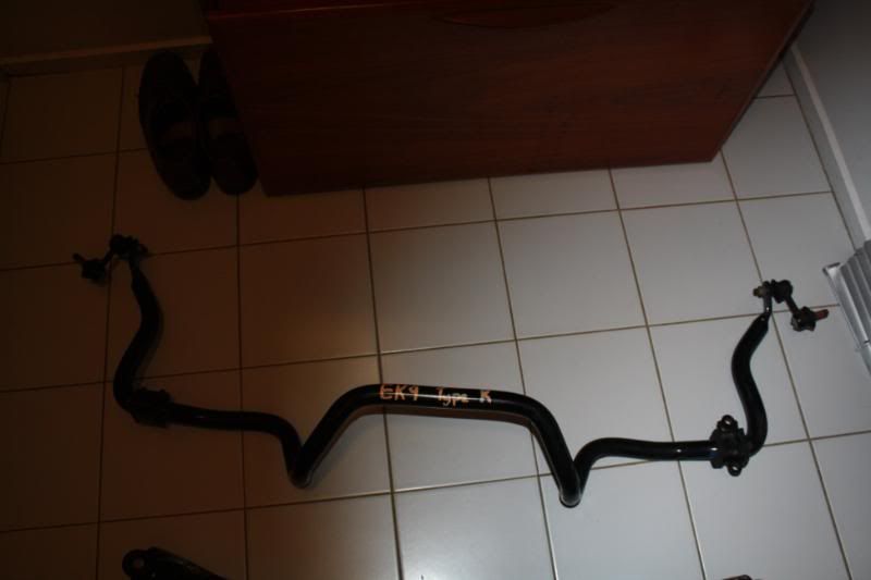

Ek9 front sway

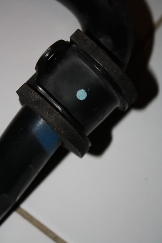

The bushes were in good condition!
http://i88.photobucket.com/albums/k1...e/IMG_0456.jpg

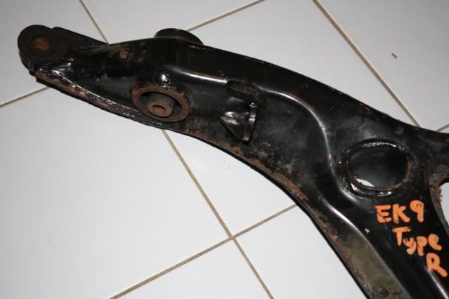

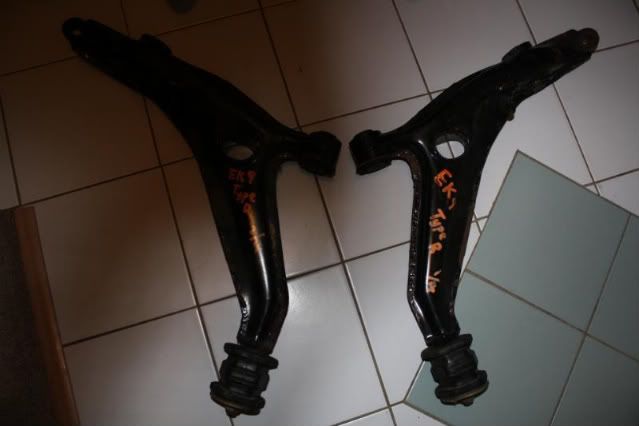

Ek9 front LCA's
http://i88.photobucket.com/albums/k1...e/IMG_0450.jpg
Slight surface rust, no biggy is spray the shit out of em with rust converter later on.
http://i88.photobucket.com/albums/k1...e/IMG_0451.jpg

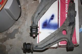

Here are the cxi lca's, notice there is no hole for the endlinks!
http://i88.photobucket.com/albums/k1...e/IMG_0837.jpg

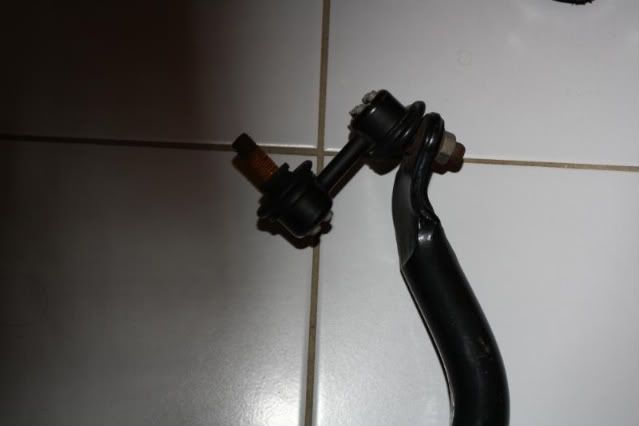

Those expensive end links were in great condition too, slight rust on the bolt but some silicon spray fixed em up!
http://i88.photobucket.com/albums/k1...e/IMG_0453.jpg
I learnt from all my ****ing around that yes the ek9 fron lca's fit straight onto the AUDM cxi frame (Thanks killa from manila and Lls)!!

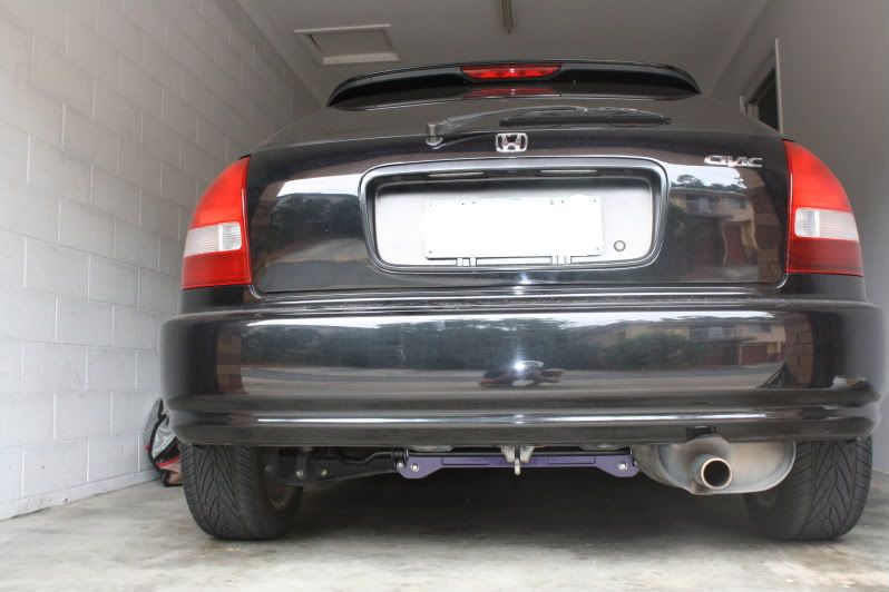

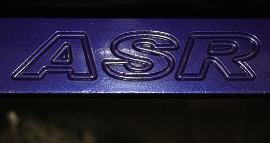

Sparkle sparkle, pearl purple/blue, gave me something to do.
http://i88.photobucket.com/albums/k1...iovine/asr.jpg

ek4 front sway = ek9 front sway
both 26mm afaik
